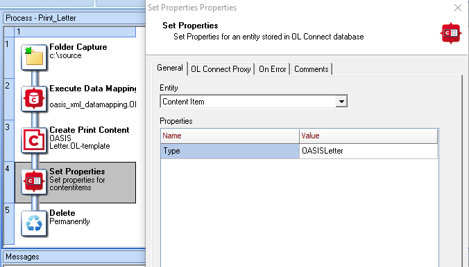

First phase: creating print content items
In the first phase, the print content is created.
The process shown here creates letters and sets a property (Type: OASISLetter) on the new content items in the Connect database using the Set Properties task.

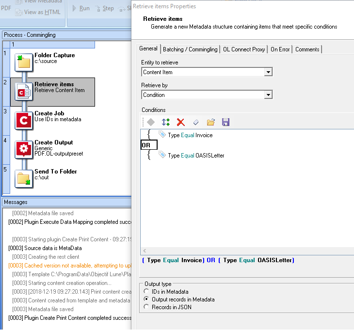

Second phase: generating print output
In the second phase, a process uses the Retrieve Items task to get all content items that have the Type property set to either OASISLetter or Invoice.
The Create Job and Create Output task then generate the output.
Note that since the Retrieve Items task is set to retrieve content items (not content sets) the items will need to be sorted using the Batching/Commingling tab of the Retrieve Items task.
