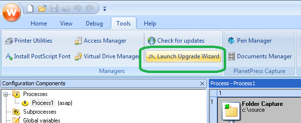

  7. To launch the Upgrade wizard, open the OL Connect Workflow 8 configuration tool and, from the Tools menu, launch the Upgrade Wizard.
    IMPORTANT: Before you start this process, make sure you have a backup of your current installation/computer.

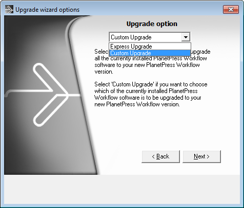

  8. Then select your upgrade type:

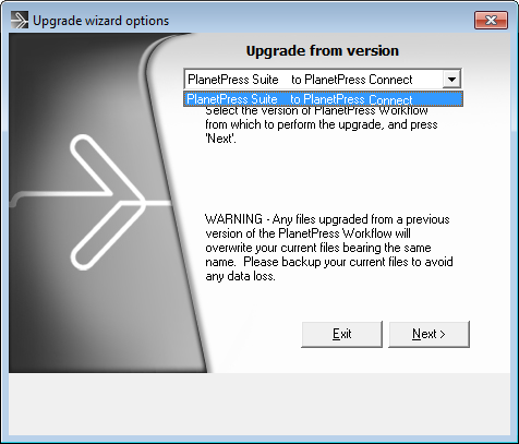

  9. Then select the product from which you wish to upgrade:

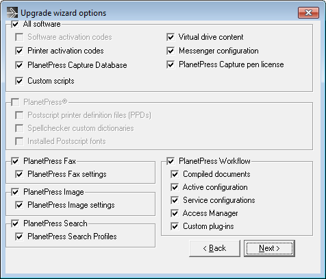

  10. If you selected to do a Custom upgrade, select the required options:
