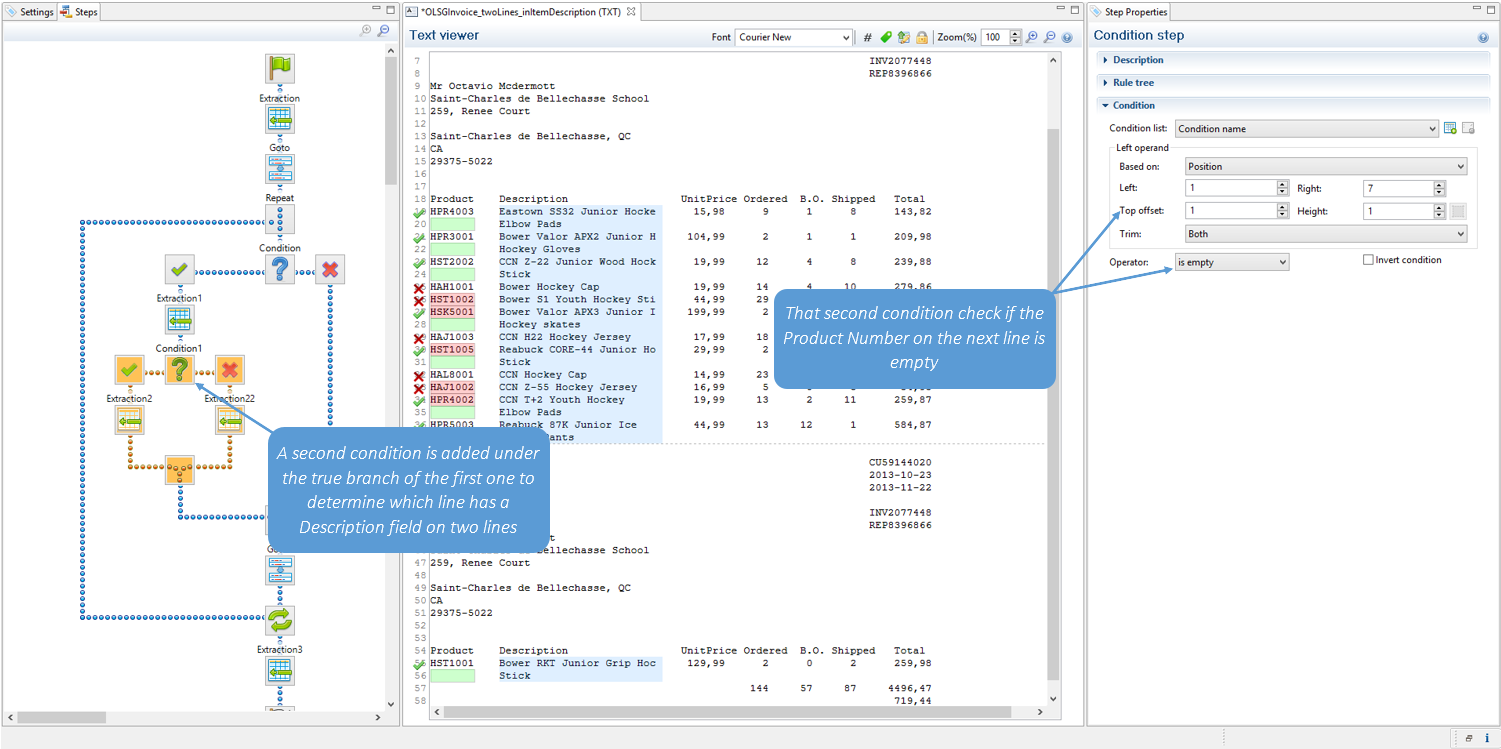

Where it isn't possible to use a setting to extract data of variable length, the key is to find one or more differences between lines that make clear how big the region is from where data needs to be extracted.
Whilst, for example, a product description may extend over two lines, other data - such as the unit price - will never be longer than one line. Either the area above or the one below the unit price will be empty when the product description covers two lines.
Such a difference can then be used as a condition in a Condition step or a Case in a Multiple Conditions step.
A Condition step, as well as each Case in a Multiple Conditions step, can only check for one condition. To combine conditions, you would need a script.
Using a Condition step or Multiple Conditions step
Using a Condition step (Condition step) or a Multiple Conditions step (Multiple Conditions step) one could determine how big the region is that contains the data that needs to be extracted.

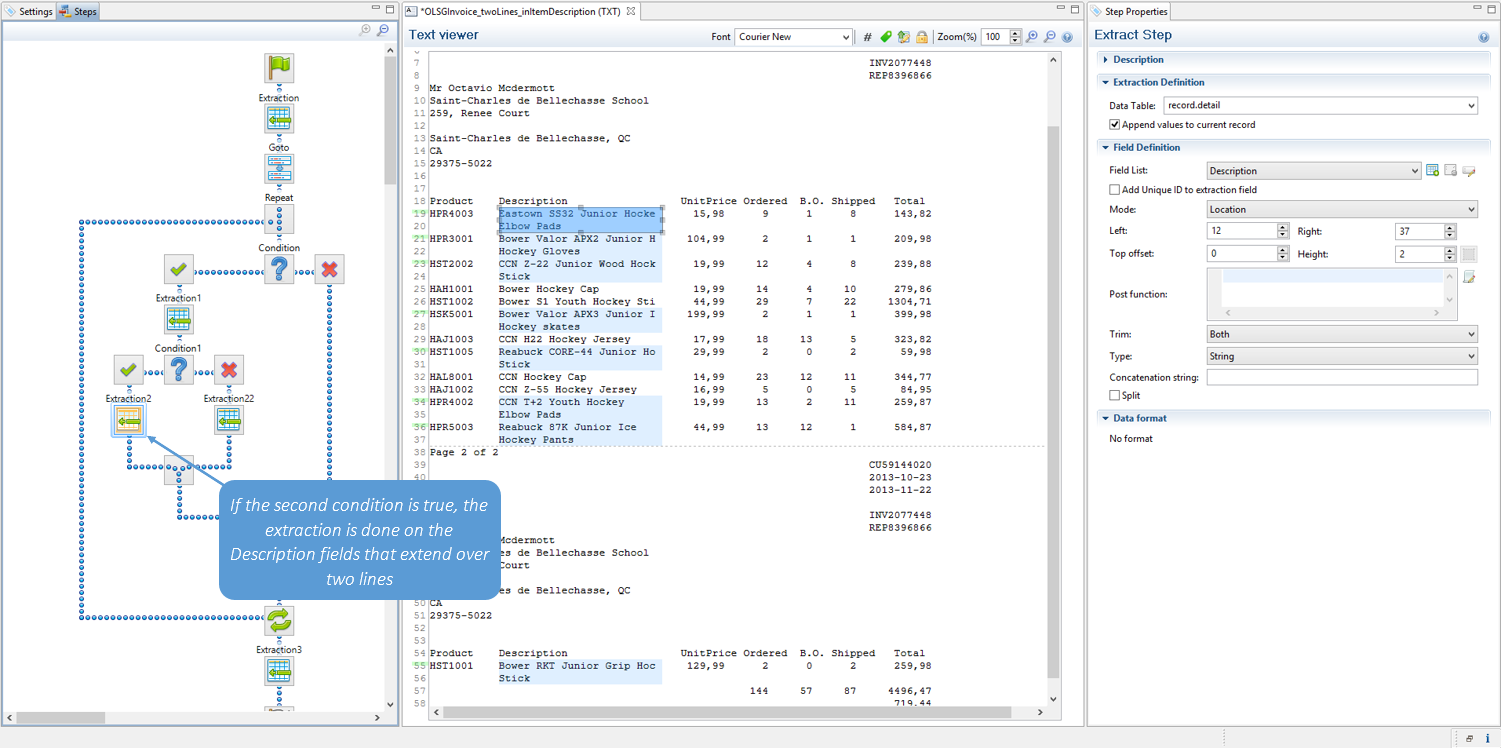

In each of the branches under the Condition or Multiple Conditions step, an Extract step could be added to extract the data from a particular region. The Extract steps could write their data to the same field.
Note: Data cannot be extracted more than once in any record, unless the Extract steps are mutually exclusive. This is the case when they are located in different branches of a Condition step or Multiple Conditions step.
Inside a Detail table, multiple Extract steps may extract the same data but each of them will create a new child record in the Detail table.
If you tick the Append values to current record option when several steps are extracting the same field, the step will error out.
Tip: Create and edit the Extract step in the 'true' branch, then right-click the step on the Steps pane, select Copy Step, and paste the step in the 'false' branch. Now you only have to adjust the region from which this Extract step extracts data.
To learn how to configure a Condition step or a Case in a Multiple Conditions step, see Configuring a Condition step.
