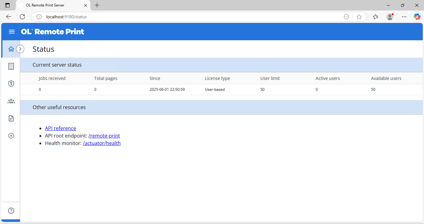

The OLRP Server provides a management console that can be accessed by URL at the appropriate IP address and port, for example, http://127.0.0.1:9180. The left menu provides access to different features, Help, and can show icons or icons and descriptions using the toggle button in the upper left. By default, the console can only be accessed from the local machine where the OLRP Server is installed.
The home or Status page displays the current status of the server:
  • Jobs received.
  • Total pages received.
  • Starting date for job and page counts.
  • The licensing model.
  • User limit, with active and available users.
This page also provides links to API documentation.
Console Status or home page, showing the server status and the left-menu navigation options that appear on all pages.
For more information about listed jobs or users, or to update this information, select the feature in the left menu.
