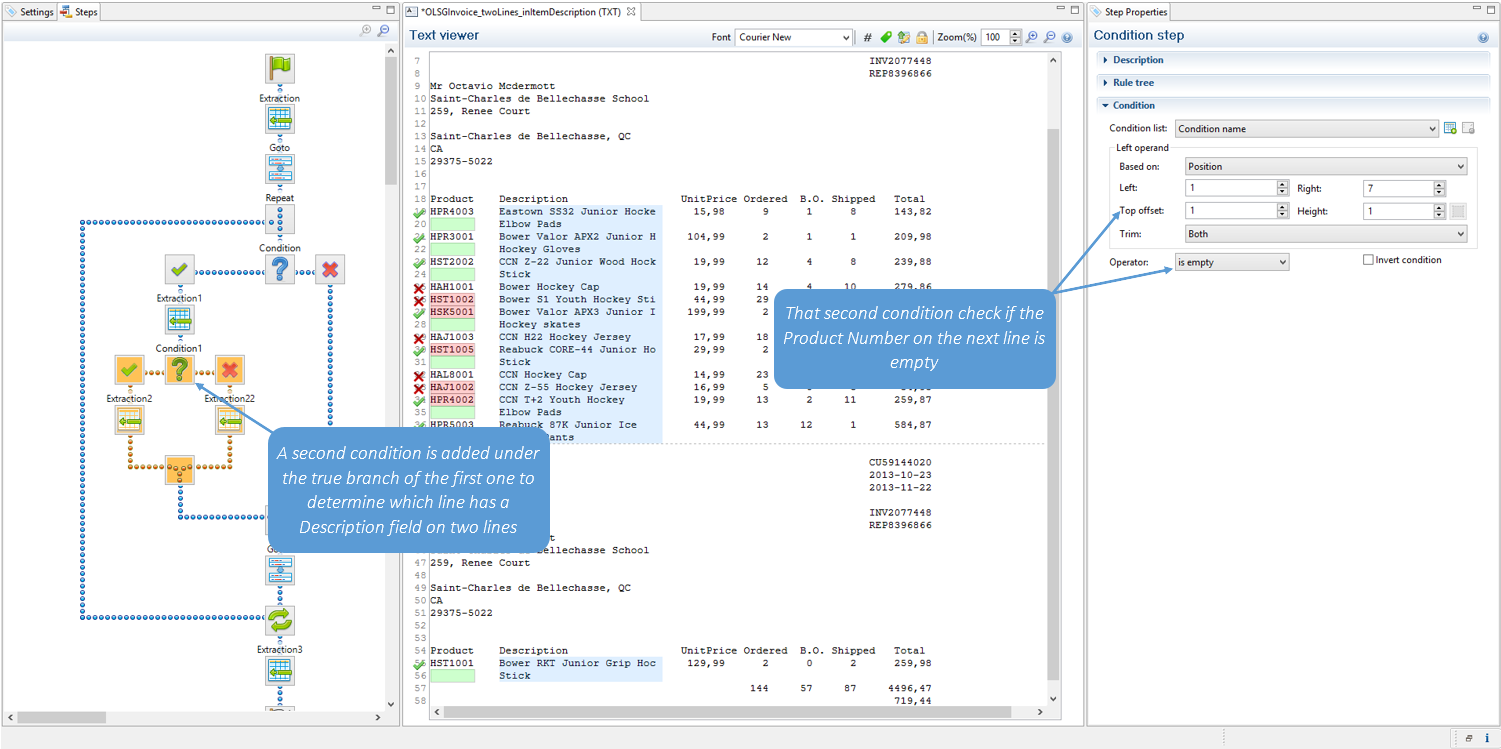

Such a difference can then be used as a condition in a Condition step or a Case in a Multiple Conditions step.
A Condition step, as well as each Case in a Multiple Conditions step, can only check for one condition. To combine conditions, you would need a script.
Using a Condition step or Multiple Conditions step

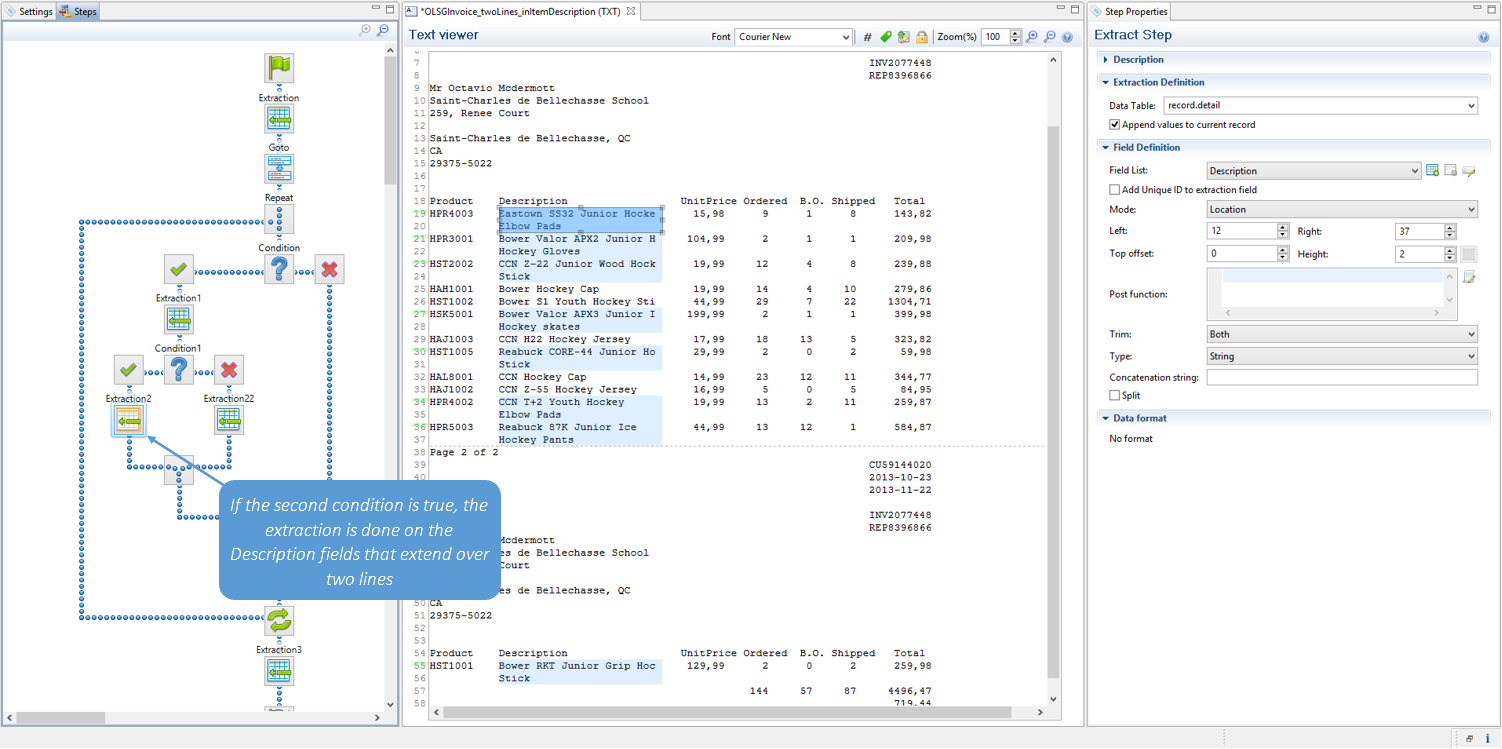

Using a Condition step (Condition step) or a Multiple Conditions step (Multiple Conditions step) one could determine how big the region is that contains the data that needs to be extracted.
In each of the branches under the Condition or Multiple Conditions step, an Extract step could be added to extract the data from a particular region. The Extract steps could write their data to the same field.
Fields cannot be used twice in one extraction workflow.
Different Extract steps can only write extracted data to the same field in the Data Model, if:
  • The field name is the same. (See: Renaming and ordering fields.)
  • The Extract steps are mutually exclusive. This is the case when they are located in different branches of a Condition step or Multiple Conditions step.
  • The option Append values to current record is checked in the Step properties pane under Extraction Definition.
Create and edit the Extract step in the 'true' branch, then right-click the step on the Steps pane, select Copy Step, and paste the step in the 'false' branch. Now you only have to adjust the region from which this Extract step extracts data.
To learn how to configure a Condition step or a Case in a Multiple Conditions step, see Configuring a Condition step.
