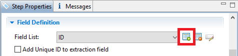

Via the Step properties pane

Adding fields dynamicallyOutside of the DataMapper the Data Model cannot be changed. It isn't possible to add fields to it when using the data mapping configuration in Workflow. It is however possible to add data to existing fields via Workflow; see About adding fields and data via Workflow. Editing fieldsThe list of fields that are included in the extraction, the order in which fields are extracted and the data format of each field, are all part of the Extract step's properties. These can be edited via the Step properties pane (see Extract step properties). Renaming and ordering fieldsThe order and the names of fields in the Data Model can be changed via the properties of the Extract step that they belong to.
See Order and rename fields dialog. Remember that fields cannot have the same name, unless they are on a different level in the record.
