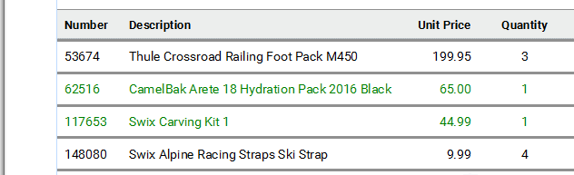

Styling based on a value in a detail table
Styling rows or cells in a detail table based on a value in the detail table goes a bit different.
First set an ID on the detail table as a whole and create a script that uses thatID tbody as the script's selector. If for example the ID is table_1, the selector will be: #table_1 tbody. Then write a script like the following:
for(var i = 0; i < record.tables.detail.length; i++){
if(record.tables.detail[i].fields['Shipped'] == 1)
query("tr:nth-child(" + (i+1) + ")", results).css('color','green');
This script loops over a detail table, evaluating the field Shipped. If the value of that field is 1, it looks up the corresponding row in the results (the object that contains the selected detail table) and colors the text of that row green. (See also: query() and css().)
