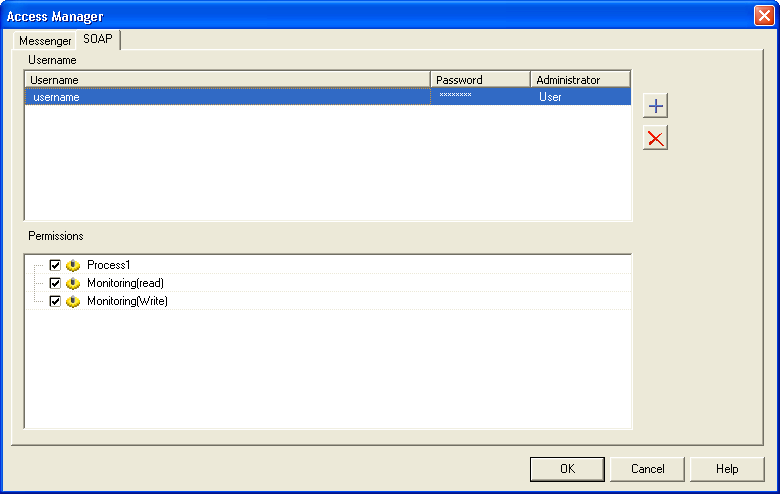

SOAP Access
The SOAP tab of the Access Manager controls access from SOAP clients to local processes and SOAP processes. Each user name entered in this dialog can have access to one or more processes.
Adding a new SOAP user
To add a new SOAP user:
  1. Click on the button.
  2. Enter the following information under the Username column for the new entry that was created:
    • User name: An alphanumerical user name for the user.
    • Password: A password to protect the user. Note that the password will always revert to ******** (8 stars) when clicking outside of this box - that is normal and is meant to protect the length of the password as much as its contents.
    • Administrator: Choose the permission type
      • User: Can access none, some, or all of the processes, selected individually in the Permissions section.
      • Admin: Has access to all processes and features. When this option is selected, the Permissions section is grayed out an all options are selected in it.
      • Disabled: Has access to nothing. The result is the same as not having this user defined at all, but has the advantage that a disabled user can be reactivated with a simple click.
  3. Define the permissions for the user (see below).
  4. Click OK to save the changes.
Defining or changing permissions
The Permissions section of the SOAP tab displays all of the processes that are available in the live configuration (the one that the PlanetPress service uses). To change or define the permissions for a SOAP user:
  1. In the top Username section, click on the user name of which to modify permissions.
  2. Place a checkmark in each process that the user should have access to.
  3. Check Monitoring(read) to give permission to the GetProcessList and GetProcessTaskList actions for SOAP.
  4. Monitoring(write) is currently not implemented.
  5. Click OK to save the changes.
In order for the changes made here to be effective, you will need to restart the PlanetPress Messenger service. This can be done via the PlanetPress Workflow Service Console.
