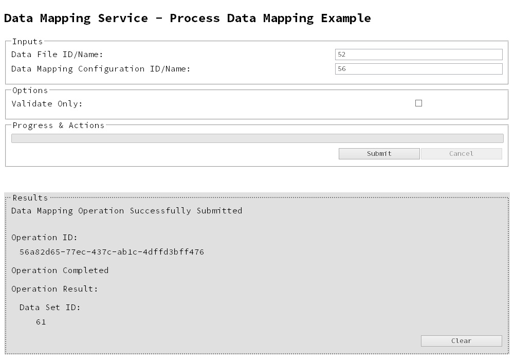

Screenshot & Output
Usage
To run the example simply enter the Managed File ID or Name for your data file and your data mapping configuration (previously uploaded to the file store) into the appropriate text fields, and then check any options that you may require:
  • Validate Only - Only validate the Data Mapping operation to check for mapping errors (no Data Set is created).
Lastly, select the Submit button to start the data mapping operation.
The progress of the operation will be displayed in the progress bar, and once the data mapping operation has completed, the ID of the Data Set created will be returned and displayed to the Results area.
If the operation was to only validate the data mapping, then a JSON Data Mapping Validation Result will be returned and displayed instead.
