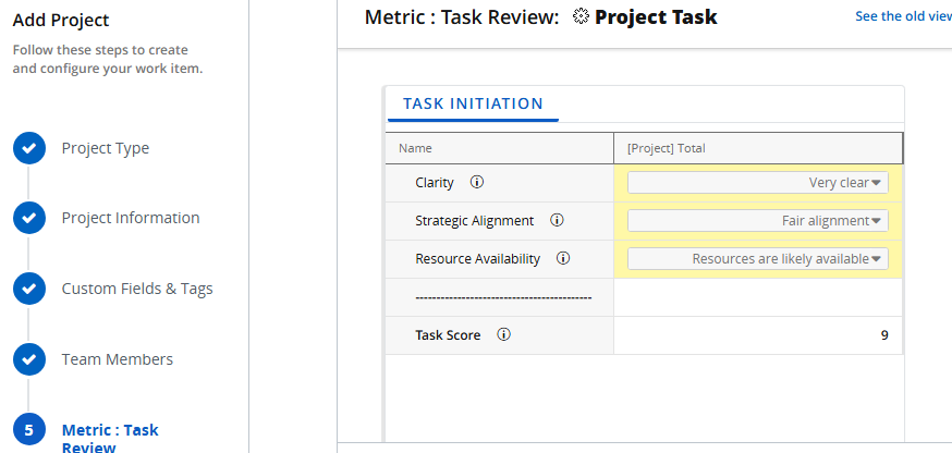

Example: Marilyn's organization wishes to evaluate Projects on three criteria to ensure they are running smoothly: clarity, strategic alignment, and Resource availability. To accommodate this, Marilyn creates a "Project Review" Scorecard Metric that can be used to evaluate Projects. She associated it with the "Project" Object Type, which means it will automatically appear on all work items created from it.
Each task is expected to undergo three separate evaluations that match up with the Metric's three views: Task Initiation (before the task begins), Mid-Progress Review (halfway through the task), and Wrap-up (once the task has concluded).
When it is time to evaluate the Project, a user can open up the "Project Review" Scorecard Metric on a work item and choose the appropriate values for each criterion:
Tip: Scorecard Metric tabs can be configured to appear while users create new work. This allows the user creating the work item to add Metric values that appear as soon as the work is created.

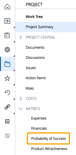

Select Project
→ Metrics → the name of a Scorecard Metric from the Navigation Menu.
Note: If you do not see the name of your desired Scorecard Metric, it might not have been attached to the work item.
Select the Edit Table button to enter "Edit Mode":
Select scores for the line items using the drop-down menus of unlocked (yellow) cells:
Note: White cells are locked from editing. Contact someone with the "Lock Metrics" Project Tasks permission to unlock them for you if you need to enter information.
Select the Save Changes button to save your new values:
Caution: Clicking on Cancel will discard all of your changes.
After clicking Save Changes, your scores will be saved. You can also view the score total if an administrator has added a "Calculated Line Item" on the Scorecard Metric template:
