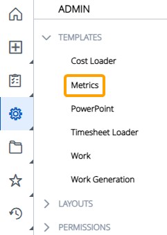

  1. Select Admin → Templates → Metrics from the Navigation Menu.

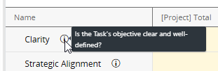

    • Description: Describe the criterion that will be used to score the work item. The description will appear as a tooltip on the Scorecard Metric.

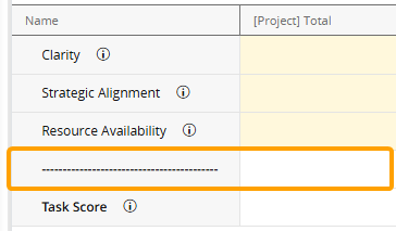

    Tip: Strongly consider adding a "Separator" line item below all of your criteria line items. To do so, add a "SEQ" number that is greater than all of the other line item "SEQ" numbers and select "Separator" from the "Data Type" field. Also, you may want to add a string of dashes as the line item name.
    This will create a line that separates your criteria from the total score on your Scorecard Metric.

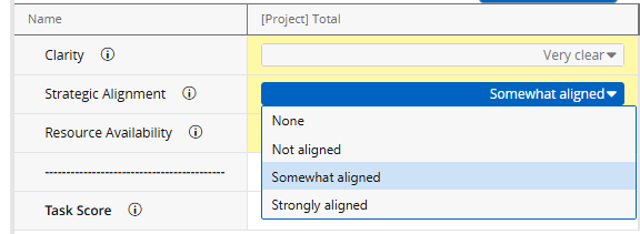

  13. Configure the Scorecard Metric criteria values.
    Note: These fields determine the values that will appear when users open each line item's drop-down menu on the Scorecard Metric.
    They also determine how each selection will contribute to the total score.

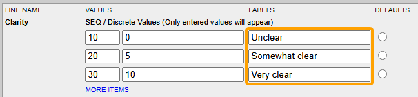

    Fill in the following fields for each of the line item's drop-down selections:
    • Values (SEQ): Enter a number that determines the selection’s position in the line item's drop-down menu. Lower numbers appear at the top and higher numbers appear at the bottom.
      Tip: Consider using multiples of 10 or 100 instead of simply counting up one-by-one ("1", "2", "3", etc.). This will make it easier to add new selections between existing ones later on.
    • Values (Discrete Values): Enter the value that the selection will contribute to the total score. The total score will add up all of the values of the selected drop-down choices.
      Note: Users will not see these values on the actual Scorecard Metric; only the labels (below) that represent them.
      Example: For the "Clarity" line item, selecting "Unclear" will contribute nothing to the final score, selecting "Somewhat clear" will contribute 5 points to the final score, and selecting "Very clear" will contribute 15 points to the final score.
    • Labels: Enter the value that will be displayed for the selection in the line item's drop-down menu.
      Example: For the "Clarity" line item, the three labels will be displayed as three drop-down choices on the Scorecard Metric.

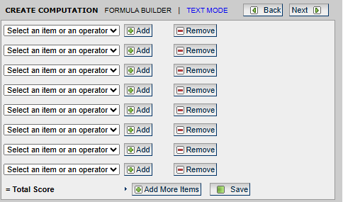

  16. Use the "Create Computation" window to create a formula that adds the line item's values together.
    Note: See Computation Metric Tab for more information.
    Example: To create a simple formula that adds up the scores of each criteria for the final score, use the drop down menus to select each line item as well as "+" between each one.
