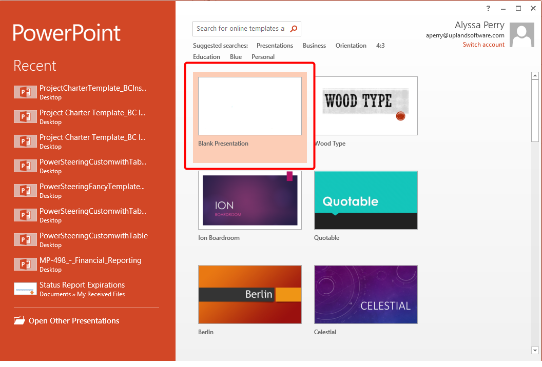

1. Create New Blank Presentation
  1. Open MS PowerPoint.
  2. Double click Blank Presentation to create a new blank PowerPoint presentation.

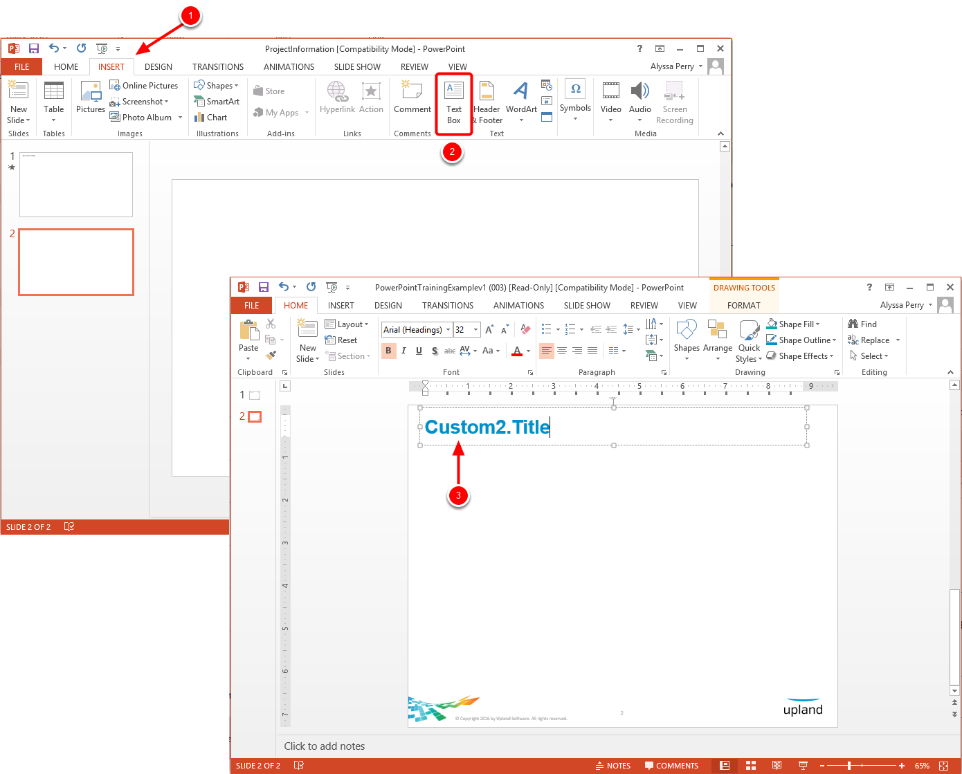

2. Add Data Token
Add Data Token

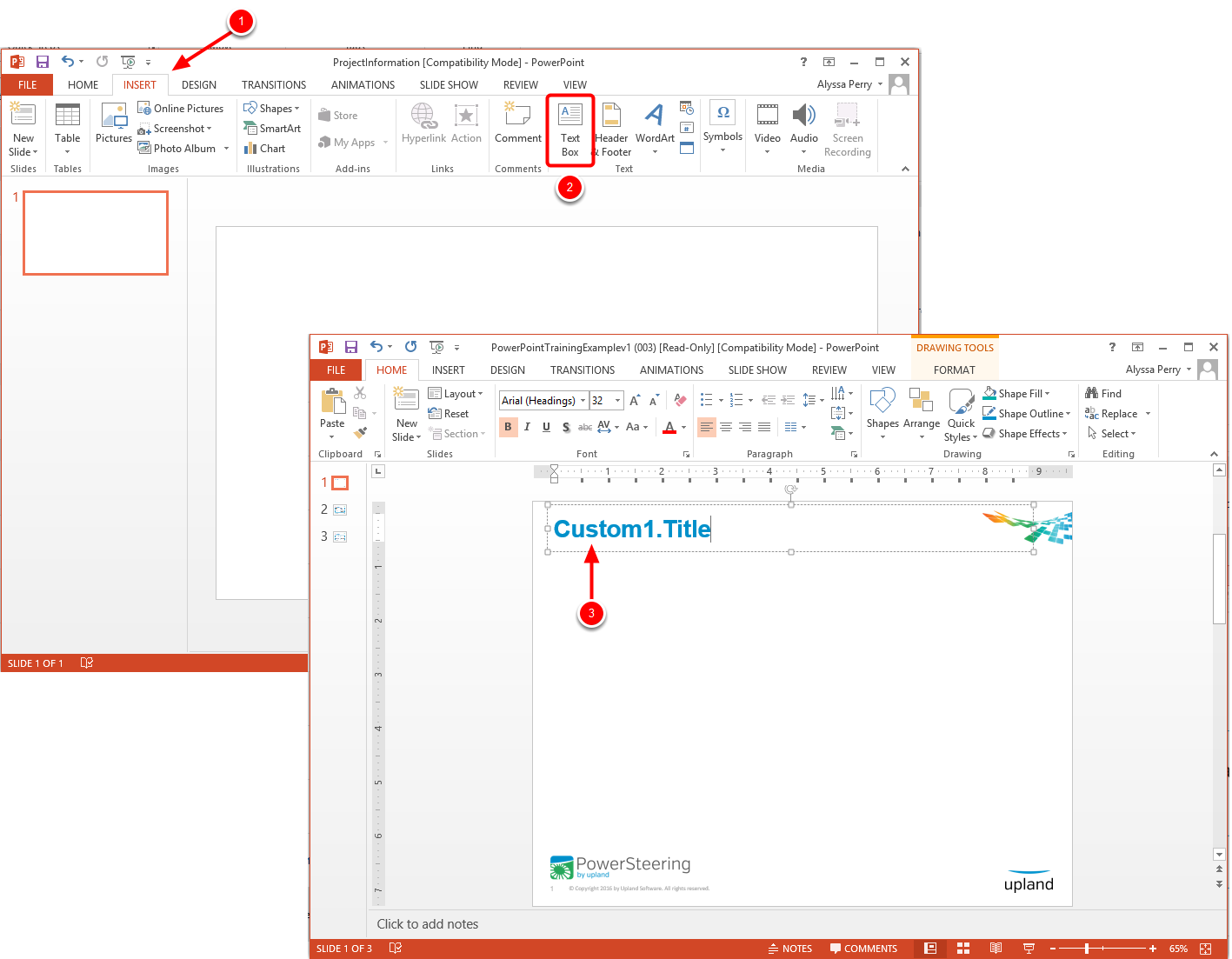

  1. On the ribbon, click the Insert tab.
  2. Click the Text Box button.
  3. Drag to draw a text box anywhere on the slide.
  4. In the text box, type {Custom1.Title}.
Note: This data token can also be entered in the Title box of a pre-formatted slide.
Note: This data token tells PowerSteering that this is a custom PowerPoint slide and will be replaced by the text entered in the Title field during when the PowerPoint is run. If you are creating a template with multiple slides, the same data token with an updated slide number ({Custom2.Title}, {Custom3.Title}, etc.) must be added to each subsequent slide.

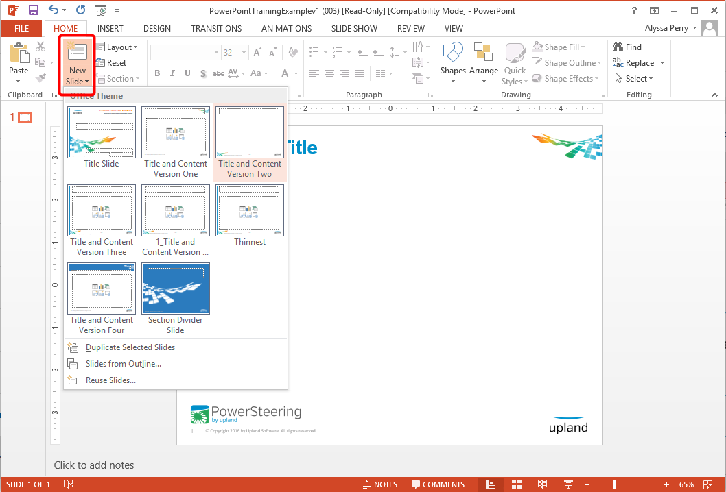

  1. On the ribbon, click the Home tab.
  2. Click the down arrow on the New Slide button.
  3. Click the slide format you want to use.
  4. Repeat Steps 1 - 3 to add additional slides to your PowerPoint template.
3.1 Add Data Token
Add Data Token
  4. In the text box, type {Custom2.Title}.
Note: This data token tells PowerSteering that this is a custom PowerPoint slide and will replaced by the text entered in the Title field when the PowerPoint is run. If you are creating a template with multiple slides, the same data token with an updated slide number ({Custom2.Title}, {Custom3.Title}, etc.) must be added to each subsequent slide.

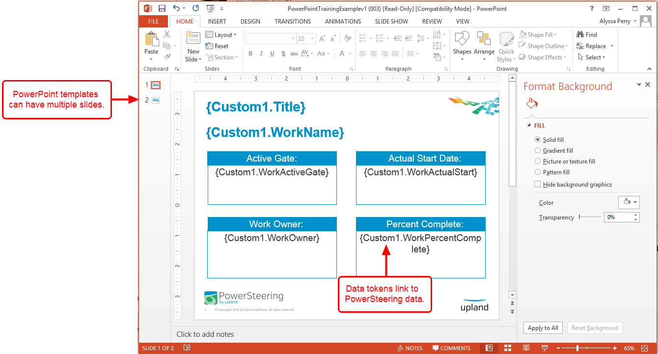

  • Format your slides as you would like them to appear in the finished presentation using tables, text, and/or data tokens. See Data Tokens for Custom PowerPoint Slides for a list of all of the available data tokens. These data tokens must be entered exactly as written in , and do not change with subsequent slides. For example, {Custom1.WorkName} does NOT change to {Custom2.WorkName} on a second slide.
Caution: Each data token must be located in its own text box or table cell separate from other text. The PowerPoint will not run correctly if text and data tokens are entered in the same text box or table cell.

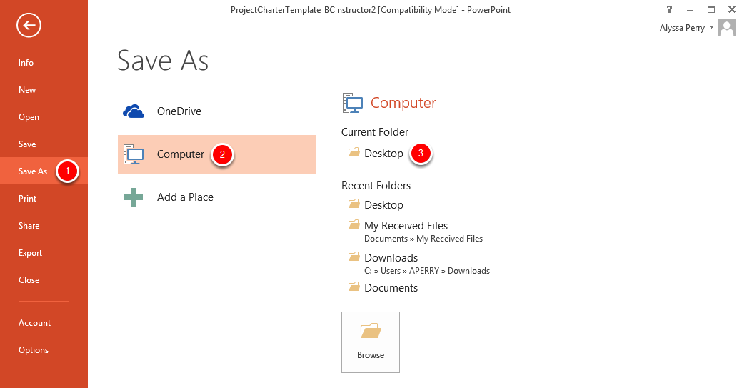

  1. Click File in the ribbon menu.
  2. Click Save As.
  3. Click Computer.
  4. Under computer, select a location where you want to save your file or click the Browse button to specify a location.

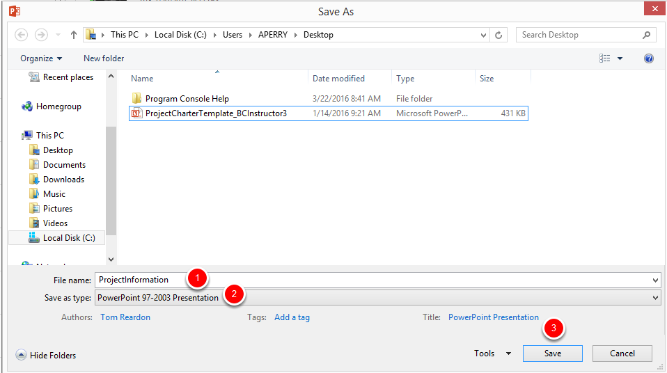

  1. Enter the file name. Note: PowerSteering does not support file names that contain spaces. If spaces are included in the file name, the PowerPoint template will load into PowerPoint branding, but will not run correctly.
  2. Click the Save as type drop down menu and select PowerPoint 97-2003 Presentation. Note: PowerSteering does not support .pptx files at this time.
  3. Click Save.

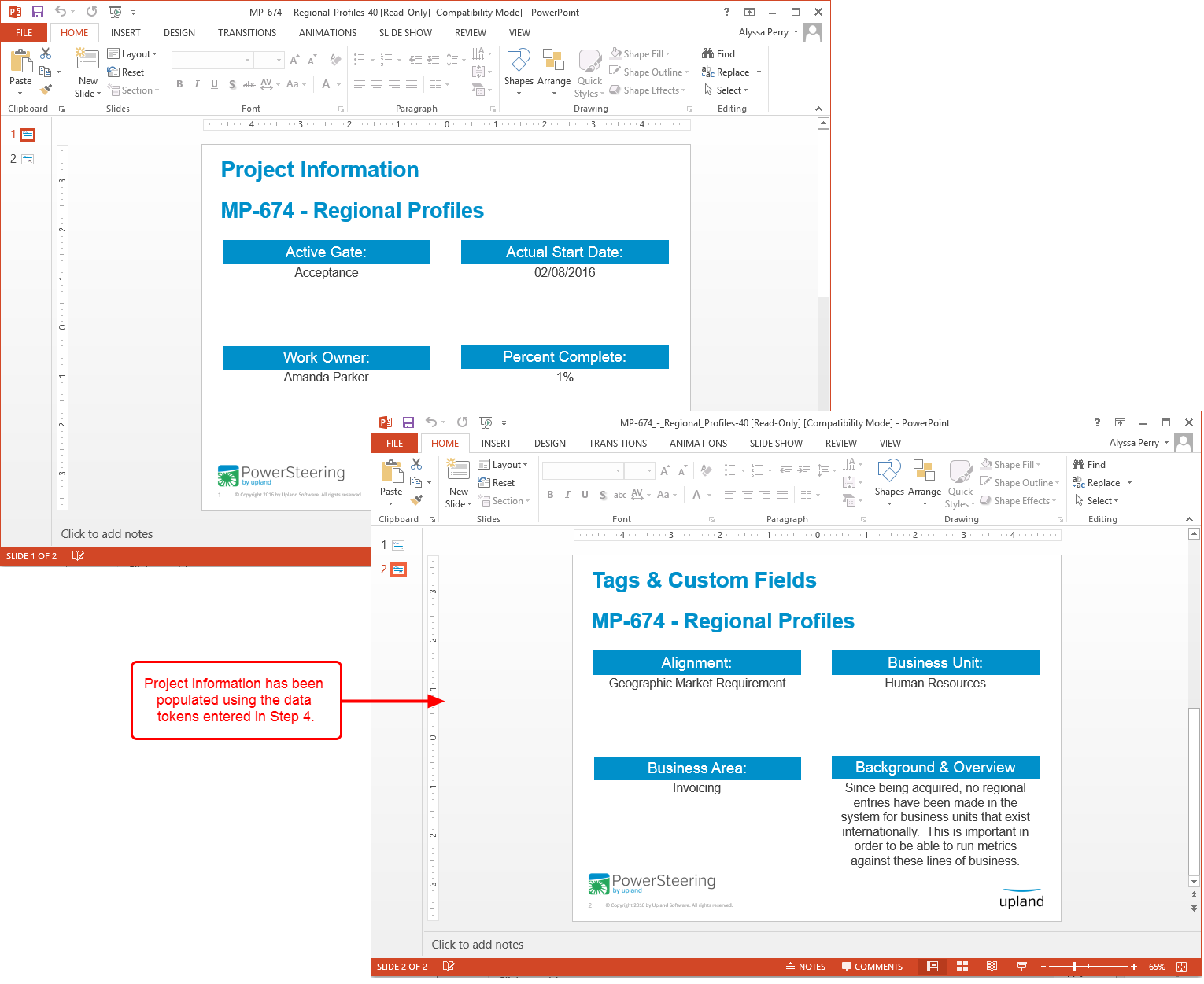

  • Above is the PowerPoint that was generated from this custom template.
