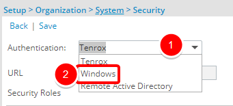

  4. From the OBS System page click the Security button.
  5. from the Authentication selection list, choose Windows as the Authentication mode to allow users to log on to the PSA application without having to define a separate set of user names and passwords.
    Select Windows
    Note: Select the Remote Active Directory option for IBM systems. When this option is selected, the URL displays the location of the Web service used to authenticate the user to the Active Directory. The format of the URL is https://<Server Name>/<Virtual Directory Name>/<Web Service Name>.

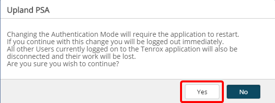

  6. Click Yes to confirm your changes.
    Click Yes
    Caution: Changing the Authentication Mode will require the application to restart. If you continue with this change you will be logged out immediately. All other Users currently logged on to the PSA application will also be disconnected and their work will be lost.
