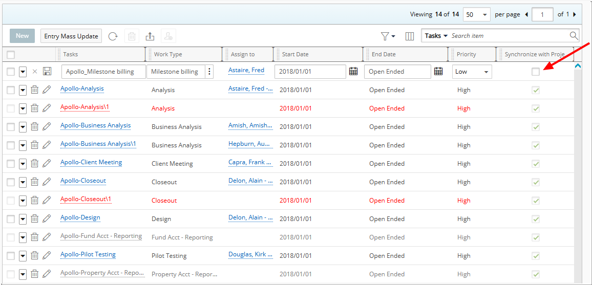

Show the Synchronize with Project Planner Column in the Project Tasks List
  1. From the Task List page click Column Selection .
  2. From the Available Columns list on the left, select Synchronize with Project Planner.
  3. Click the Add button to add it to the Selected Columns on the right.
  4. Click Save.
  5. The Task list page will be refreshed and you will now see the Synchronize with Project Planner column.
    Note: The Synchronize with Project Planner option is selected by default.
  6. Click the Edit button to enable inline editing of the Task you wish to modify.
  7. Clear the Synchronize with Project Planner checkbox to remove the Task from Project Planner.
  8. Click Save to save your changes.
  9. The Task will no longer available in Project Planner.
    Note: The system will automatically adjust any dependencies to maintain project continuity.

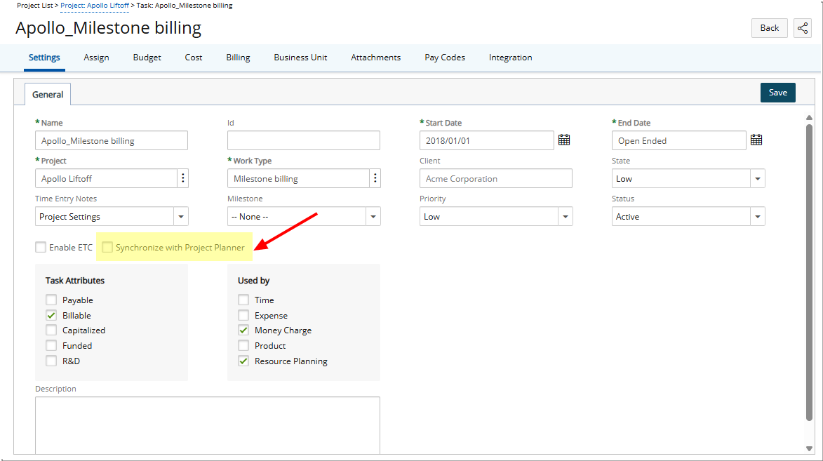

Edit the Synchronize with Project Planner Setting for a Task
  1. From the Task List page click the name of the Task you wish to modify.
  2. Upon the Task edit page displaying, clear the Synchronize with Project Planner checkbox to remove the Task from Project Planner.
  3. Click Save to apply your changes.
  4. The Task will no longer available in Project Planner.
  5. Click Back to return to the previous page.
