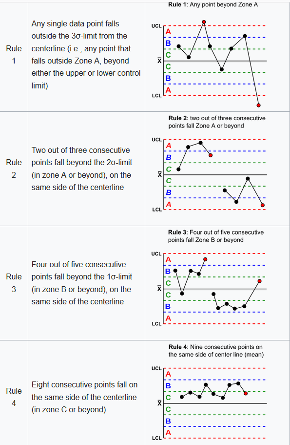

The chart's rules are not configurable, they display automatically depending on the data. The chart is based on the four rules of Western Electric:

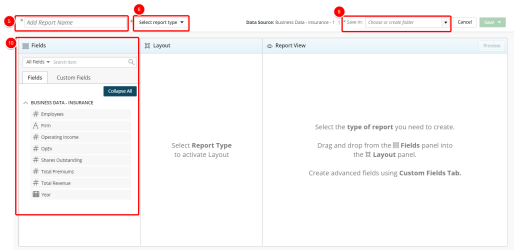

To create a Box Plot:
  1. Select Box Plot from the list of available report types.
