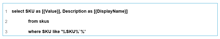

The query must reference the lookup job property (via substitution); for example, %lookupjobpropertyname% and specify the display text and internal value columns by using an "as" clause.
See the Query (SKU job property) example below.
The server expects {Value} and {DisplayName} to be returned from the database when the Lookup function is applied. Other columns returned are ignored.
Note: The example above uses “like” and the percent symbol (%) wildcard character. This is what the server uses to determine substitution. A back tick character (known as a back apostrophe) (`) must be included in the quoted string as shown above. The back tick is used to ignore  the percent symbol and not process it as part of a substitution. This allows it to pass through the SQL engine where it is used as the "like"  wildcard character.

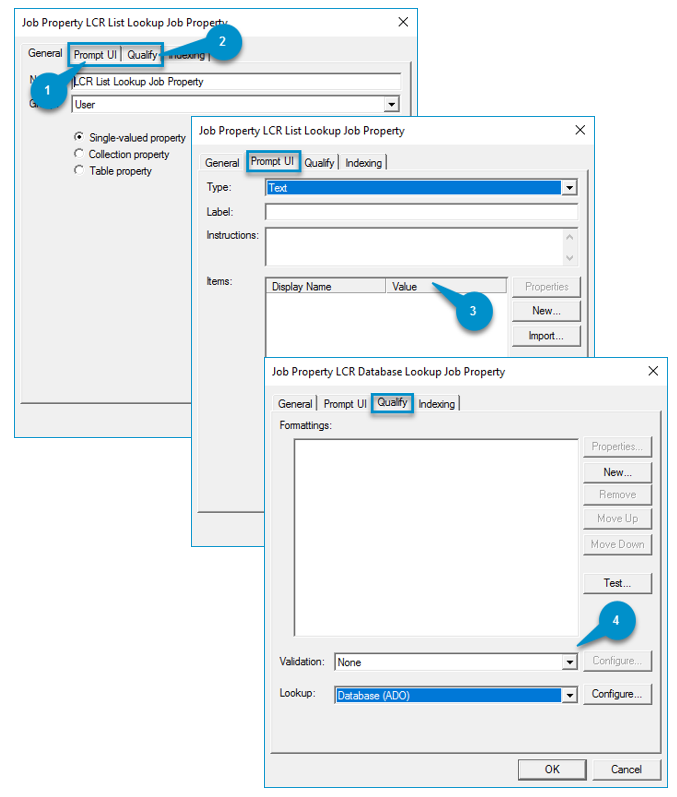

Lookup Job Property at a Glance
Lookup Job Property Legend
1. Prompt UI  tab
Use to create and configure a List lookup.
2. Qualify  tab
Use to create and configure a Database lookup.
Note: The Qualify tab is also used to qualify a List lookup.
3. Prompt UI (list) parameters
Use to specify list items, display names, values and more. See Configuring  a List lookup for more information.
4. Qualify (database) parameters
Use to specify, configure, test database parameters and more. See Configuring a Database lookup for more information.
