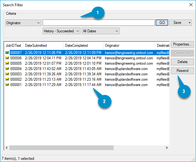

Search Filters at a Glance
Search Filters Legend
Description
1. Criteria area
Use the Criteria area to:
  • Criteria drop-down list - Select Search Filter criteria.
  • Search bar - View and select search filters.
  • Go - Run search filters.
  • Save, Save As, Columns - Name and save search filters and/or customize the search result columns.
2. Search Results area
View search results list.
3. Properties, Cancel job, Delete, and Resend buttons
Use the buttons to:
More about search filters
There is more you can do with search filters like customize the columns that appear in the search results area, view and edit message properties, cancel messages in process, delete and resend messages.
