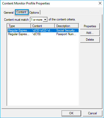

CM Profiles
  • CM Profiles content criteria are created to identify Social Security, Passport, and Driver’s License numbers for redaction.
See the Social Security Number CM Profile content criteria example below.

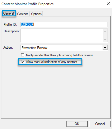

Redaction Settings
Manual redaction is applied to documents that will allow Security Station and Content Review users to identify and redact other critical content, if necessary.
See the CM Profile Properties dialog box with manual redaction example below.

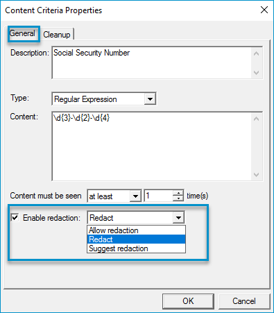

Redact (Auto redaction) is applied to documents that meet the content criteria specified for Social Security, Passport, and Driver’s License numbers.
See the CM Profile > Content Criteria Properties dialog box with Redact example below.

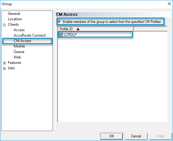

Group access to CM Profile IDs
Security Station and Content Review groups are given access to the appropriate CM Profile IDs.
See the Group Properties > CM Access dialog box example below.

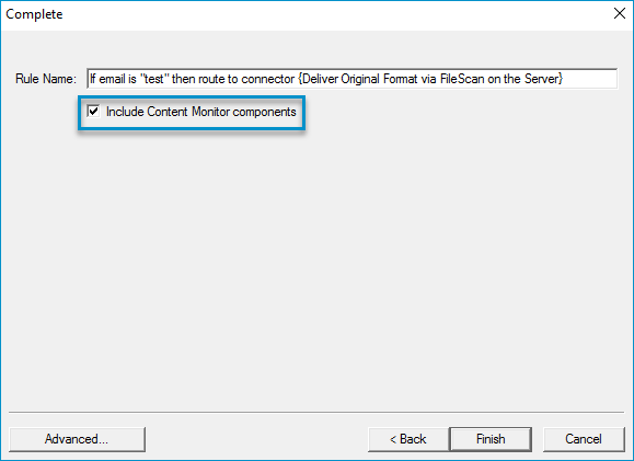

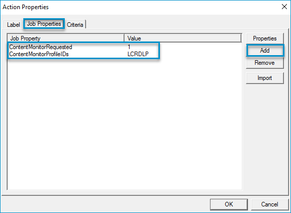

User RuleSets CM Components and Job Properties
CM components and job properties are included and added to the user-defined ruleset.
See the Rule Properties dialog box examples below.
