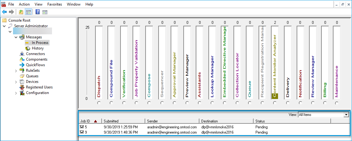

Viewing and/or troubleshooting redaction
To view the status of a redaction message
Use the Messages > In Process and History folders by selecting Messages on the Server Administrator tree.
See  the Messages > In Process folder example below.

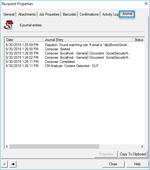

To troubleshoot a redaction issue
Use the Journal on a redaction-related Server Administrator resource by selecting the Journal tab that appears on the Properties dialog box; for example, the Messages > History > Recipient Properties dialog box.
The journal contains the history of a message. If any errors occur during the processing of the message, they are listed in the journal. For example, if you want to track the delivery status of a message, the message journal can tell you if the message failed delivery and was resent at a later time.
See the  Messages > History > Recipient Properties > Journal example below.
