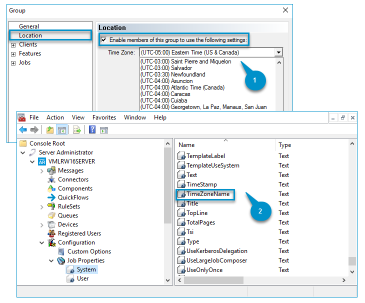

Group-specific Time Zones at a Glance
                                                             Group-specific Time Zones Legend  |
                                                             Description  |
                                                         1. Group Properties dialog box  |
                                                         Use the Group Properties > Location setting to enable members of a specific group to use the time zone selected.  |
                                                         2. Job Properties > System > TimeZoneName  |
                                                         Used by the server to verify the appropriate Group > Location setting, and date and time zone variables are applied to specific groups and their workflow cover page, fax top line, and email notification templates. Note: This happens behind the scenes and does not require any additional configuration.  |
Accessing Group-specific time zone settings
You can access the Group Properties > Location setting by using Configuration > Groups on the Server Administrator tree.
To access Groups
Expand the Server Administrator tree, if necessary.
Expand Configuration.
Select Groups. The groups appear in the details pane.
Select a group. The Group Properties dialog box appears.
Specify or modify the Location setting as needed.
Click OK.
