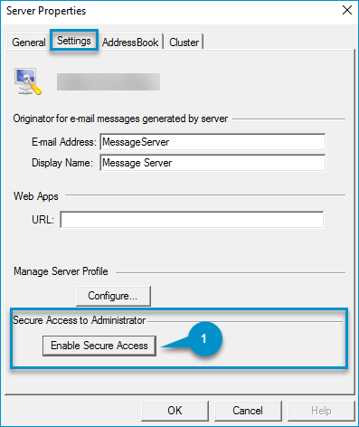

Server Administrator Secure Access at a Glance
Server Properties Dialog Box Legend
Description
1. Enable Secure Access button
Use to enable group members Server Administrator MMC access and select groups.

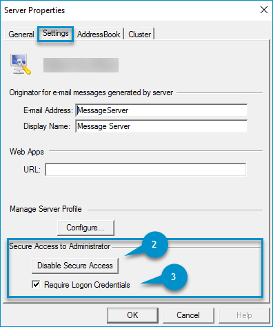

2. Disable Secure Access button
Use to remove secure access to the Server Administrator MMC. Only the secure access flag is removed from the group configurations. Secure access groups are not removed or deleted.
Note: You will not be able to see the Administrator > Access property in the Group properties dialog box when this property is disabled.
3. Require Logon Credentials
Use to enforce logging on before accessing the Server Administrator tree.
Notes:
  • When an Administrator or Power user logs on with  a username and password,  the logon credentials are verified to ensure they are valid. Once the verification is complete then the username is provided for a Group lookup to determine which group(s) the user belongs to.
  • If logon credentials are not required, the first part indicated above is skipped. The user account logged into Windows and running the Server Administrator MMC  is used for the Group lookup.
  • Administrator or power user group members that do not successfully log on will not be able to expand the Server Administrator tree or access any of its nodes.
Accessing Server Administrator properties
You can access the Server Administrator properties by using the Server Administrator tree.
To access Server Administrator properties
  2. Expand the Server Administrator tree, if necessary.
  3. Right-click the Server name that appears on the tree. The Properties shortcut menu appears.
  4. Select Properties. The Server Properties dialog box appears.
  5. Use the Server Properties dialog box to apply new or modify the server properties.
