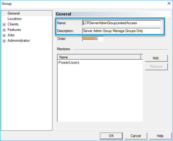

The Administrator creates a PowerUsers group.
See  the Configuration > Group Properties dialog box example below.

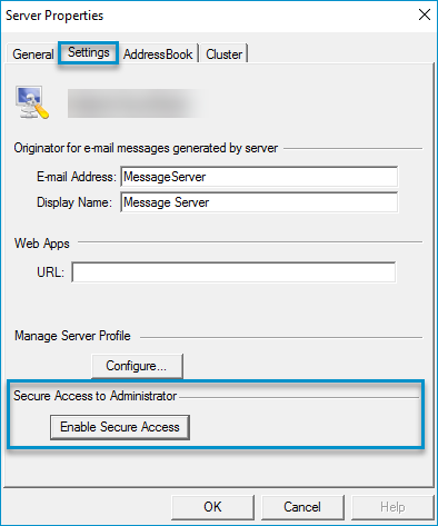

The Administrator enables secure access.
See the Server Properties > Settings dialog box with Enable Secure Access example below.
The Administrator requires logon credentials to be provided before accessing the Server Administrator.
See the Server Properties > Settings dialog box with Require Logon Credentials example below.

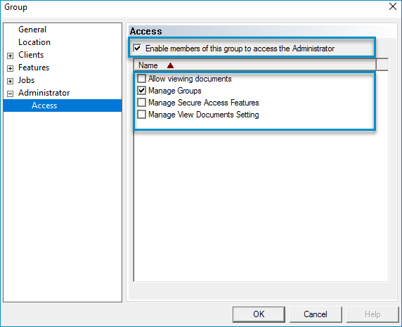

The Administrator applies only the Manage Group permission to the PowerUsers group.
See the Configuration > Group Properties > Administrator Access dialog box with Manage Groups permission example below.
