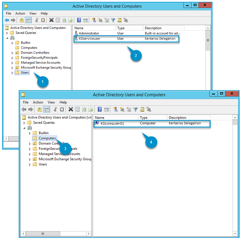

Windows Active Directory Users and Computers at a Glance
AD Users and Computers Legend
Description
1. Users folder
Use the Users folder to open, create, or select a service account user for Kerberos Delegation.
2. Service Account User
Use the Service Account User properties to configure Kerberos Delegation.
3. Computers folder
Use the Computers folder to open, create, or select a computer(s) for Kerberos Delegation.
4. Computer
Use the computer properties to configure Kerberos Delegation.
