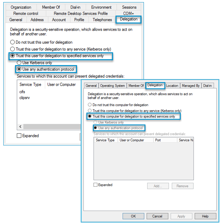

Active Directory for Users and Computers and Delegation Properties
The Administrator specifies the following Kerberos Delegation settings for the Service Account user and computers by using Windows Administrative Tools > Active Directory for Users and Computers.
See the Active Directory for Users and Computer Delegation properties selected below.
Note: See Configuring Windows for Kerberos Delegation for more information.

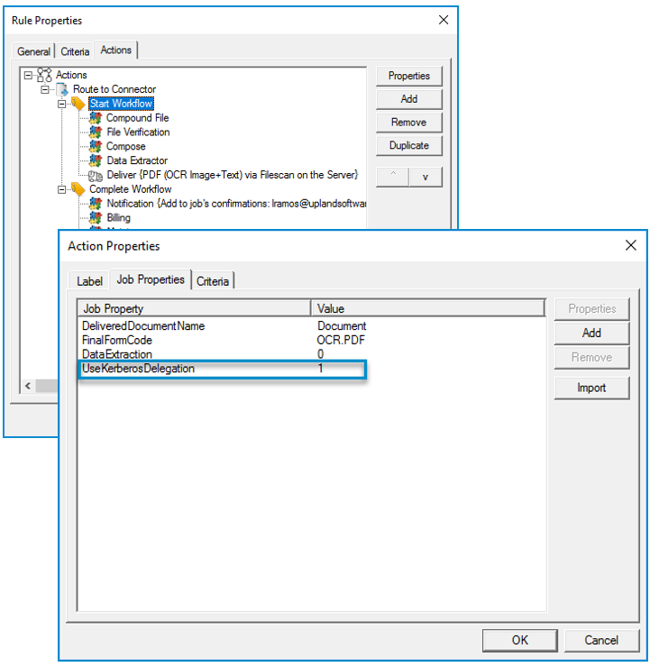

Workflow Rule and System UseKerberosDelegation Job Property
The Administrator applies Kerberos Delegation to a network share folder workflow rule by using the System job property UseKerberosDelegation and setting it to a value of 1.
See the Rule Properties > Actions > Job Properties dialog boxes below.
See Applying  Kerberos Delegation to a Network Share Folder Workflow for more information.
