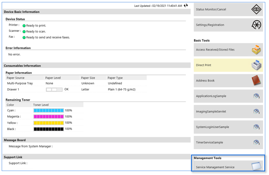

Open the device’s EWS (Embedded Web Server) by entering the device’s IP address in your browser’s address bar.
Select the Management Tools > Service Management Service option located at the bottom right of the page.
See the EWS Home page example below.

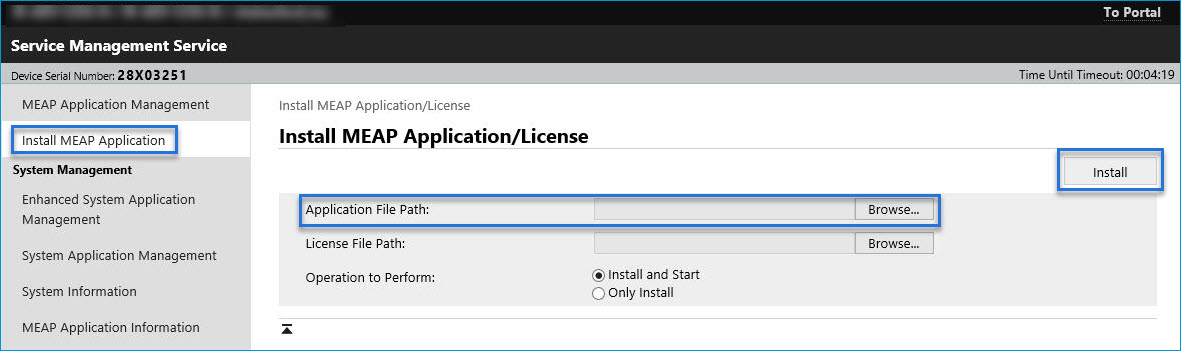

Select Install MEAP Application.
Find the Upland AccuRoute MEAP Application JAR file (\Program Files (x86)\Upland AccuRoute\DeviceClient\Installation\Canon) by using the Application File Path > Browse button.
See the Install MEAP Application/License page example below.
