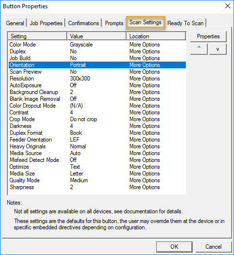

  6. Select the appropriate button. The Button Properties dialog box appears.
  7. Select the Scan Settings tab.
See the Button Properties > Scan Settings dialog box example below.
button properties scan settings dialog box example
  1. Select Orientation. The Scan Settings Properties dialog box appears.
  2. Select Auto-detect on the Orientation drop down list.
  3. Select OK on the Scan Setting Properties dialog box. Auto-detect appears as the updated value in the Setting table.
  4. Select OK on the Button Properties dialog box.
  5. Select OK on the Device Group Properties dialog box.
