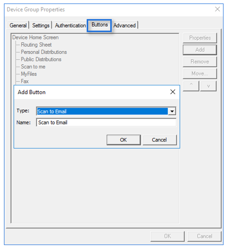

To set up Scan to Email
  2. Expand Devices on the Server Administrator tree.
  3. Right-click the appropriate device group. The Properties shortcut menu appears.
  4. Select Properties. The Device Group Properties dialog box appears.
  5. Select the Buttons tab.
  6. Select Add. The Add Button dialog box appears.
See the Device Group Properties > Buttons dialog box example below.
device group properties buttons dialog box example scan to email
  1. Select OK. The Scan to Email button appears on the Device Home Screen tree.

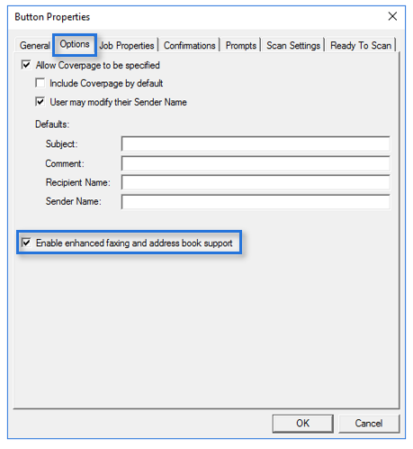

  7. Select Properties.
See the Fax Button Properties dialog box example below.
fax button properties dialog box example enable enhanced faxing
  1. Select Enable enhanced faxing and address book support.
  2. Select OK on the Button Properties dialog box.
  3. Select OK on the Device Group Properties dialog box.

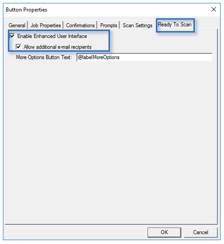

  8. Select the Ready to Scan tab on the Button Properties dialog box.
See the Button Properties > Ready to Scan dialog box example below.
button properties ready to scan dialog box example
  1. Select Enable Enhanced User Interface and Allow additional email recipients.
Note: The Ready to Scan tab can be used to enable Scan to Email functionality with other buttons that require scanning on your device. The Ready to Scan steps listed above can also be used for other Scan-related button setup.
