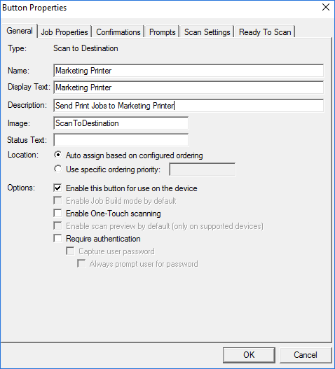

Select Marketing Printer on the list. The Button Properties dialog box appears.
See the Button Properties dialog box example below.
Type a name, for example, Marketing Printer in the Name box.
Type a name, for example, Marketing Printer in the Display Text box.
Type a description, for example, Send Print Jobs to Marketing Printer in the Description box.

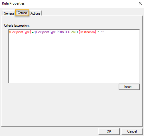

Modifying the Criteria expression
Select the Criteria tab.
In the Criteria Expression box, modify PRINTER and type the letter, E after the period in the expression.
See the Criteria Expression dialog box example below.
Select the $Recipient Type.Email expression from the Macros list if necessary
Replace the asterisk inside the quotations, "*" with Marketing. Do not remove the quotations.
Note: The server treats the delivery of the documents in this scenario as an email message. The destination can be expressed as an email address or any job property label you have used as a destination. You are not restricted to using an email address format when using the Email recipient type.

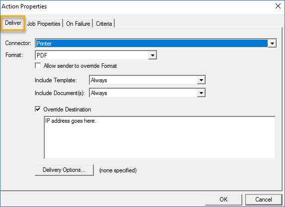

Modifying the Actions tree
Select the Actions tab and the Deliver action. The Action Properties dialog box appears.
See the Action Properties > Deliver dialog box example below.
Select the Override Destination check box.
Type the device's IP address in the Override Destination box.
Select OK on the Action Properties dialog box. The modified Deliver action appears on the Actions tree.
