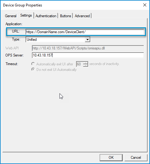

  3. Right-click the appropriate device group and select Properties. The Device Group Properties dialog box appears.
See the Device Group Properties dialog box below.
device group properties dialog box
  1. Click the Settings tab.
  2. Ensure your fully qualified domain name appears correctly in the URL.
  3. Click OK.

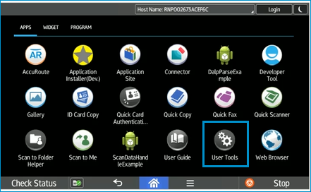

  2. Select Apps > User Tools.
See the Ricoh device > User Tools display below.
ricoh device user tools display

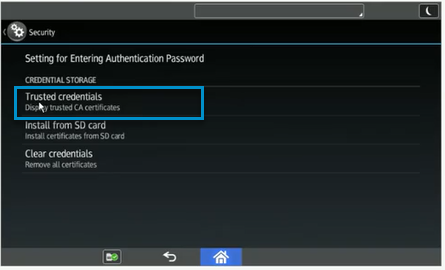

  5. Select Trusted credentials.
See the Ricoh device > Security > Trusted credentials  display below.
ricoh device security trusted credentials display
8. Verify that the Self-Signed certificate appears in the System list.
