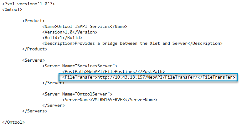

Editing the OmlSAPIU.xml file
Using Notepad, you must edit the Web API > OmlSAPIU.xml file > File Transfer information.
To edit the OmlSAPIU.xml file
  1. Open File Explorer.
  2. Go to C:\Program Filesx86)\UplandAccuRoute\AccRoute\WebAPI\WebAPI\Scripts.
  3. Find the OmlSAPIU.xml file.
  4. Right-click the file and open with Notepad.
See the OmlSAPIU.xml file below.
omlsapiu.xml file
  1. Find the <FileTransfer> tag and change http to https.
  2. Replace the IP address with your fully qualified domain name.
  3. Select File > Save.
Note: Edit the permissions in the OmlSAPIU.xml File Properties if you cannot save the file.

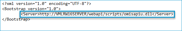

Editing the Bootstrap.xml file
Using Notepad, you must edit the Device Client > Configuration > Bootstrap.xml file.
To edit the Bootstrap.xml file
  2. Go to C:\Program Files (x86)\Upland AccuRoute\DeviceClient\Configuration.
  3. Find the Bootstrap.xml file.
See the Bootstrap.xml file below.
bootstrap.xml file
  1. Find the <Server> tag and change http to https.
  2. Select File > Save.
Note: Edit the permissions in the Bootstrap.xml File Properties if you cannot save the file.
