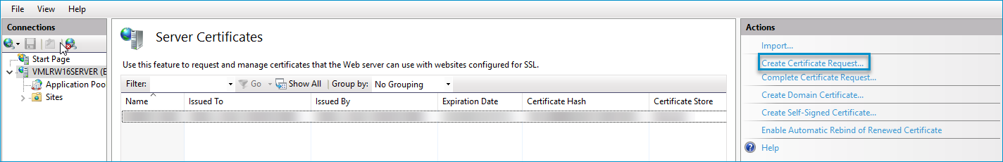

  1. Open the Internet Information Services Manager (IIS) on the computer where the AccuRoute Server is located.
  2. Select the Server connection on the Connections pane.
  3. Select Create Certificate Request on the Actions pane. The Request Certificate wizard appears.
See IIS > Actions > Create Certificate Request pane below.
iis actions create certificate request pane

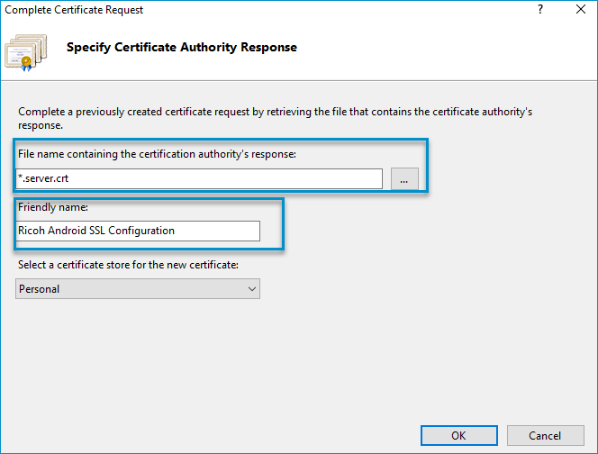

  4. Select Complete Certificate Request on the Actions pane. The Complete Certificate Request Certificate dialog box appears.
  5. Use the Browse ellipsis (…) button next to the File name box and find the Server certificate. If necessary, you can change the file name search criteria from *.cer to *.*.
  6. Select the Server certificate (*.crt) and click Open.
  7. Type a friendly name in the box provided.
  8. Click OK. The Server certificate completed request appears on the Server Certificates list.
See the Complete Certificate Request dialog box below.
complete certificate request dialog box

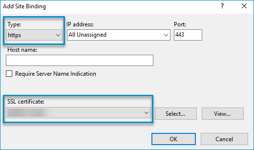

  1. Select Default Web Site on the Connections pane.
  2. Select Bindings on the Actions pane. The Site Bindings dialog box appears.
  3. Click Add. The Add Site Binding dialog box appears.
  4. Select https from the Type drop-down list.
  5. Select the Server certificate you created from the SSL certificate drop-down list box.
  6. Click OK.
See the Add Site Binding dialog box below.
add site binding dialog box
