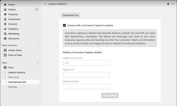

  1. Open the Adestra app in Shopify and select the Abandoned Cart menu.
    Tip: pin the Adestra app to make it easier to locate in Shopify.
  2. Check the 'Connect with a Conversion Capture in Adestra' checkbox.
    Screen capture showing the location of the abandoned cart feature in the Adestra-Shopify app and the configuration screen.
    The Adestra account ID should pre-populate based on your Shopify-Adestra integration settings.

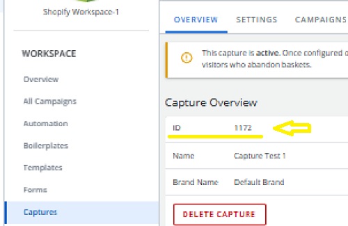

  3. Add a Capture ID (found within the capture overview in Adestra) and the associated Adestra domain (URL provided for API communication).
    Screen capture showing the location fo the Cpature ID in Adestra.
