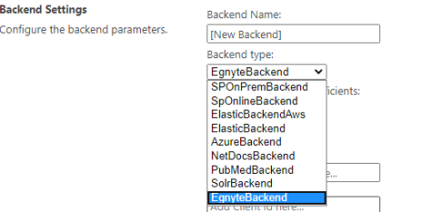

  2. Add a new backend.
  3. The Backend Settings page appears.
    Select EgnyteBackend from the "Backend type" drop-down menu:

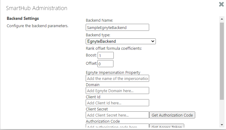

  4. Complete the following fields on the page:
    1. Egnyte Impersonation Property:
      1. The name of a property to be added to the client context properties that holds the user name of the user to be impersonated (this is done with a script, in a Query Scripting Processor stage, see section "Pipeline Stages" below)
    2. Backend Name:
      1. Name you give to your Egnyte backend
    3. Domain:
      1. The Egnyte domain you want to search.
      2. For example: myegnyteapp.egnyte.com
    4. Client Id:
      1. The Client ID provided when creating an Egnyte app
    5. Client Secret:
      1. The Client Secret provided when creating an Egnyte app

  9. Go back to the Backend Configuration page and paste the code in the Authorization Code field. See the graphic below step 4/e., above.

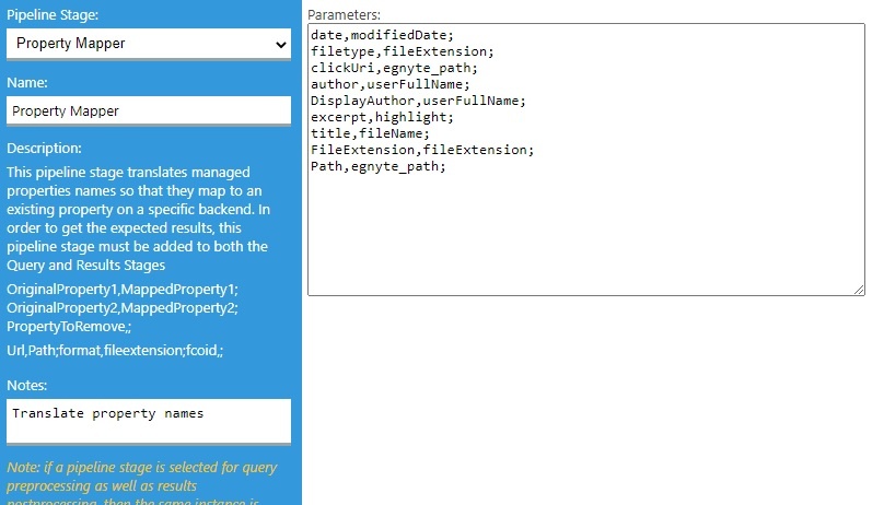

After the Backend is configured, ensure the Property Mapper pipeline stage is configured for both the Query and Results pipeline stages for your new Egnyte Backend.
If these pipeline stages are missing, add them using the following steps:
  1. Go to the General Settings page from the SmartHub Administration page: https://<SmartHub_web_app_url>/_admin.
  2. Select the Egnyte backend you have just created.
  3. Click Add a new Query Stage link.
  4. In the newly opened window, select the Property Mapper stage from the "Pipeline Stages" drop-down.
  5. Add a new name for this state.
  6. In the text area on the right, add the properties you want to map in the format described on the left panel.
  7. Save and repeat these steps for the Result Pipeline stage.

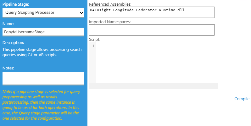

Query Scripting Processor Stage
Next, you add a Query pipeline stage called a Query Scripting Processor.
This stage adds a custom property to the Client Context object with the same name as the one you selected during Configuration step 4, for the field Egnyte Impersonation Property, shown below.
Note: The scripting processor stage is valid only as a Query pipeline stage and not as a Results pipeline stage.
ONLY C# scripting language is supported.
The script retrieves the Client Context object and uses the upn property to calculate the user name of the logged user (without the domain) and add it to the Client Context in the custom property mentioned above.
Note:  The default script should resolve the Azure AD and Windows authentications.
If a different type of authorization is used, then the script may need to be changed.
