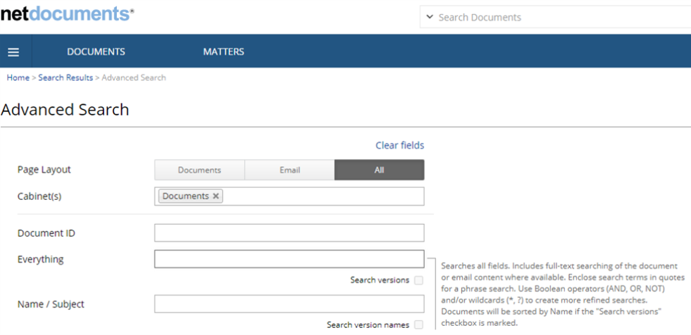

Verify Cabinet Administration Permissions
Verify the user account used the configure token authentication has cabinet administration permissions.
  1. In NetDocuments, open a cabinet that will be indexed by the BA Insight NetDocuments backend and searched by users.
  2. Select the drop-down menu for the cabinet and select Cabinet Information.
  3. The Cabinet administrator user accounts are shown listed here. See the image below.
    1. The user account used for token authentication MUST be shown in this list for each and every cabinet to be searched by the BA Insight NetDocuments backend.

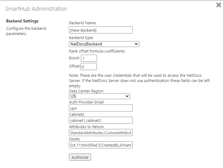

How to Add an NetDocuments Backend

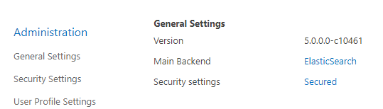

  1. Navigate to the SmartHub Administration page at http(s)://[web-app-url]/_admin
  2. Go to the General Settings page.
  3. Click the "Add New Backend" link to add your new NetDocs backend.
  4. Next, enter the Backend Name and corresponding information in the appropriate fields.
    See the following graphic.
  5. Backend type: Select NetDocsBackend from the drop-down list.
Authorization
  1. Edit "Data Center Region" (Optional)
    1. If you are using the default Data Center (US) skip this step.
    2. If you are using a different Data Center, enter the appropriate value into the field.
      1. Supported Data Center regions are: US, UK, DE, AU.
      2. European users, use UK.
  2. Use your NetDocs account credentials to log in. IMPORTANT: Your user account MUST have Administrator permissions to all the NetDocuments cabinets to be searched.
  3. Click the "allow" button to give the application full access to all resources.
    Note: If you have multiple repositories, and you want results from all of them you must set up a different NetDocs backend for each repository
  4. Click Authorize
  5. From the Configuration page, copy the code in the Authorization Code text box.
  6. Click Get Access/Refresh Tokens
  7. Copy and paste the Access and Refresh tokens.
  8. Click the OK button.
