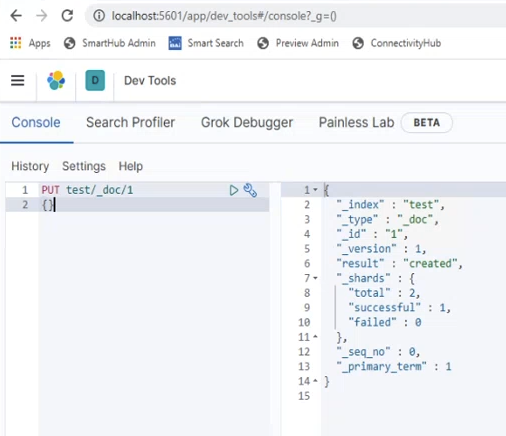

Use the following steps to initialize Kibana v7.x:
- Go to your Kibana Dev Tools.
- URL (or similar): http://localhost:5601/app/dev_tools#/console?_g=()
- Enter this command and run it:
PUT test/_doc/1

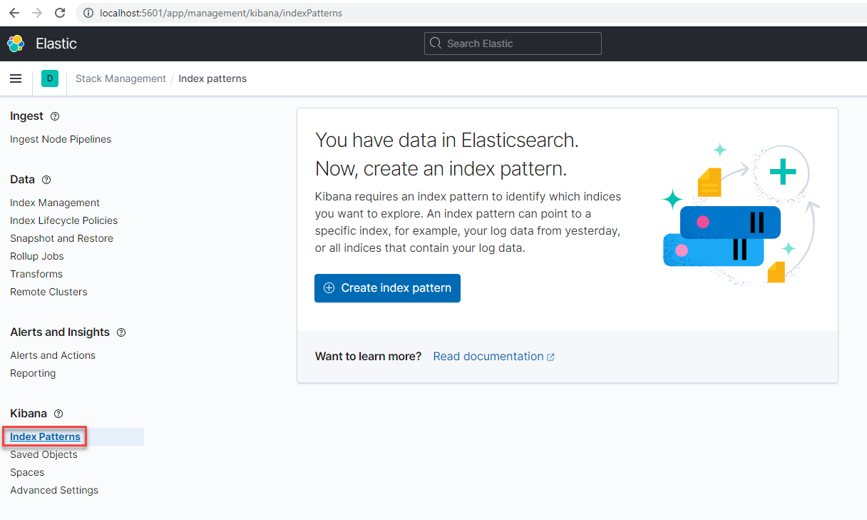

- Open Stack Management → Index Patterns:
- URL: http://localhost:5601/app/management/kibana/indexPatterns
- Create an index pattern based on index:
- Click "Create Index pattern."
- Write "test" in "index pattern" text box. NOTE: The field is case-sensitive!
- Click the Next step button.
- Click "Create index pattern"

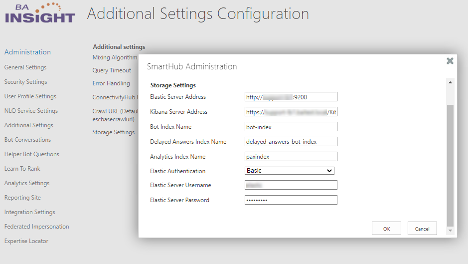

To configure Analytics, use the following steps:
- Navigate to the SmartHub Administration page by going to http(s)://[SmartHub-web-app-url]/_admin
- Go to the Additional settings page and click on Storage Settings > Edit.
- Complete all the fields shown.
Some information is pre-populated.
See the graphic below.- Elastic Server Address: URL, including port number, of your Elasticsearch server
- Kibana Server Address: URL, including port number, of your Kibana server
- Bot Index Name: Name of your bot index. Default name is bot-index.
- Delayed Answers Index Name: Name of your delayed answers index.
- Analytics Index Name. Save the changes.
- Authentication mode:
- Basic:
- Account: Necessary only for Elastic users. Username of the account used to access your Elasticsearch server.
- Password: Necessary only for Elastic password. Password of the account used to access your Elasticsearch server.
- Token Based:
- Azure App ID: Enter App IDs from Azure App created for Elastic Authentication
- Azure Secret Key: Enter Secret Key from Azure App created for Elastic Authentication
Azure Scope: Enter Azure Scope from Azure App created for Elastic Authentication

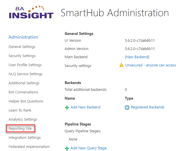

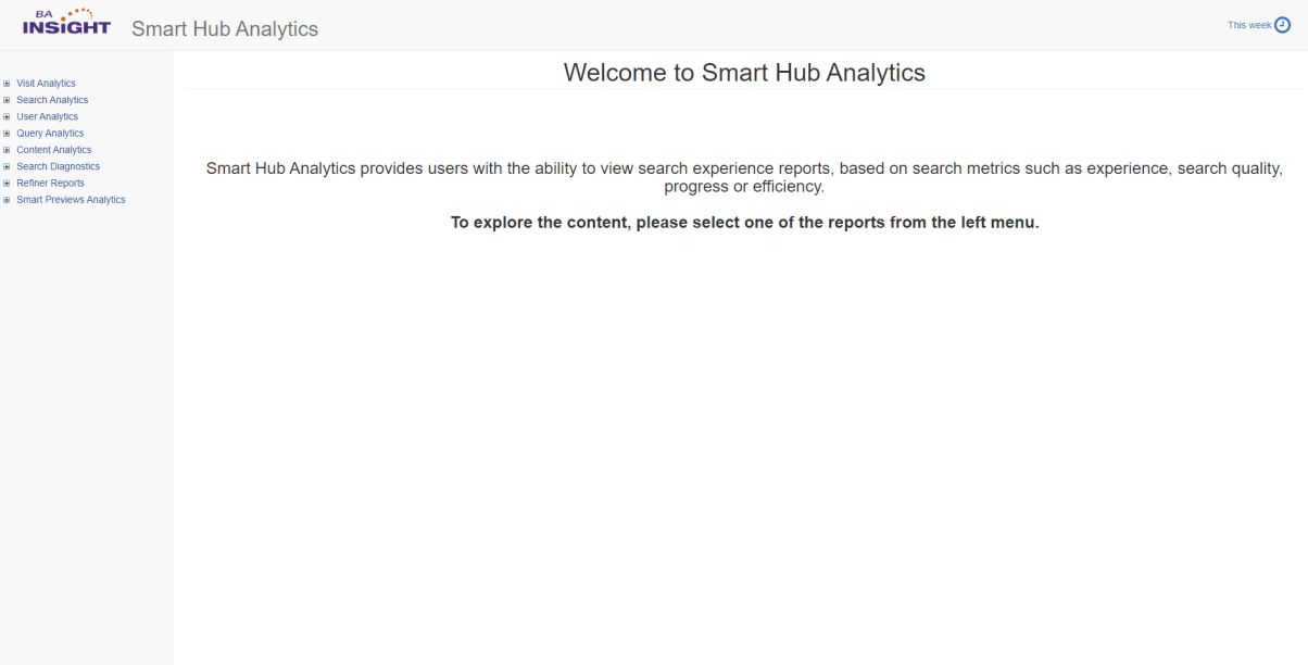

How to Access the Reporting Site
To access the Reporting Site, use the following steps:
- Navigate to the SmartHub Administration page by going to the SmartHub Admin web User interface (UI) or enter the URL in the format: http(s)://[web-app-url]/_admin
- Click Reporting Site as shown in the graphic here:
- The SmartHub Analytics reporting site appears:

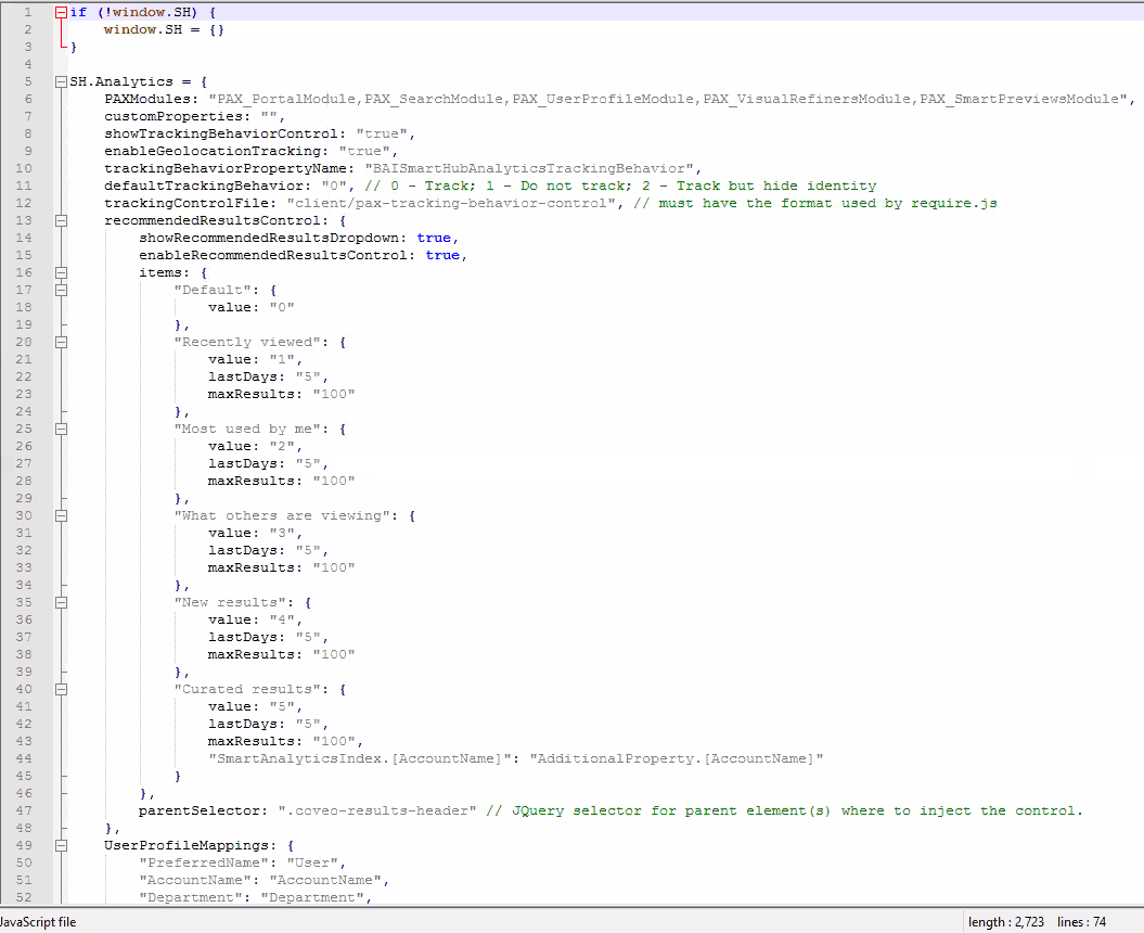

To modify the Analytics settings, you need to access two files listed below.
- Your Index or Results page custom settings file (.js):
- Located in <SmartHub_root_folder>/CustomerCustomization/settings
- If you want analytics to track data on your Index page, use your custom Index settings file: IndexCopySettingsCustomSettings.js.
- If you want analytics to track data on your (search) Results page, use your custom Results settings file: ResultsCopyCustomSettings.js. This is the natural choice.
- If you have a separate custom settings file see How to Customize Your SmartHub User Interface.
- Analytics settings: The file DefaultModuleSettings.js contains all SmartHub analytics properties, which control how analytics behaves on your web page.
- The DefaultModuleSettings.js file is stored in: <SmartHub_root_folder>/modules/SmartHubResourceLoader.

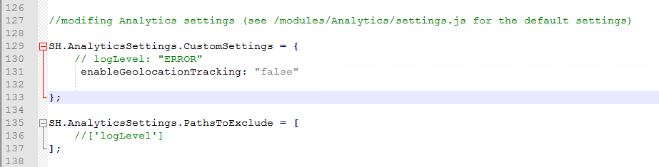

Example: Disable Geographical Location Tracking
In the following procedure you disable Geographical location tracking.
To do this, you copy the Geographical location tracking code from DefaultModuleSettings.js file into your custom settings file and change the value from true to false to disable the function.
- Open the file DefaultModuleSettings.js, shown below.
- Copy the setting
enableGeolocationTracking: "true".
Note that you can copy and modify any setting you desire. - Open your custom Results settings file and paste the setting under the SH.AnalyticsSettings.CustomSettings block.
- Change the value to "
false." - In the example below, the custom setting is added to disable the Geological Tracking option.
- Save the file.

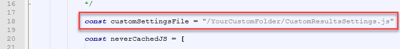

- Ensure your custom setting file is referenced by the custom Index or Results HTML pages where you want analytics to track your data.
- In the graphic below, the custom Index page IndexCopy.html references the custom settings file IndexCopyCustomSettings.js.
For more information, see How to Instruct SmartHub to Load your Custom Settings.
