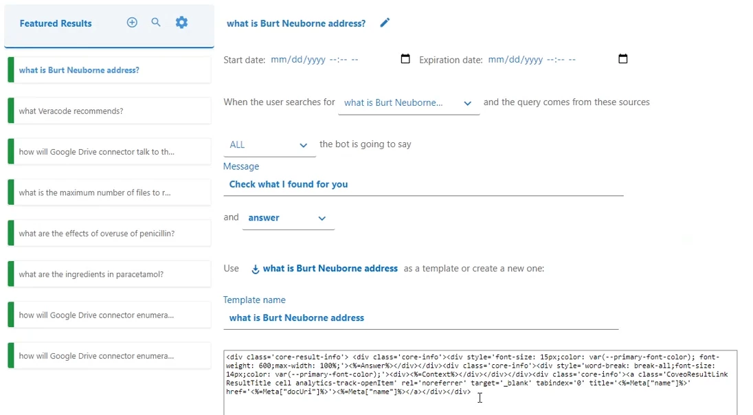

  • Featured Results
    • Requires the user ask a question using the exact text in the exact order as specified in the Featured Results configuration.

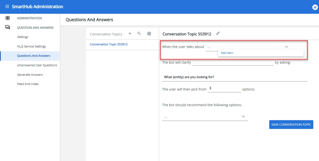

  1. Navigate to the SmartHub Administration page.
  2. From the left side panel, select Questions & Answers.
  3. Add and configure a new Conversation Topic or NLQ Q&A.
  4. Intent is set on the line "When the user talks about...".
    1. "Add item" is an intent as set in your NLQ provider:
      1. "favorite movie," "last quarter's results," "my business results," etc.
      2. For ideas of most popular user intents in queries, use SmartHub Analytics such as How to Track User Queries and Selections.
    2. The bot message and answer can then be entered/selected.
    3. All questions that match the intent item you add here receive the selected message and answer. This behavior is unique to the NLQ Q&A feature.
    4. If you configure Featured Results instead of NLQ Q&A, an exact search query must be entered instead of an intent phrase.
      1. Any question entered by the user must exactly match the question set in SmartHub (see "Pending User Questions" under Q&A) for an answer to be returned.
