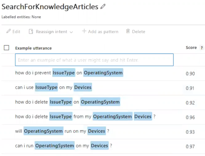

SearchForKnowledgeArticles Intent Example
  • In the example below, the intent "SearchForKnowledgeArticles" is shown.
  • Every line contains an utterance.
  • Entities in each utterance are highlighted in blue.
  • Note that entities such as IssueType, OperatingSystem, and Devices are a kind of keyword that can be recognized by your app.

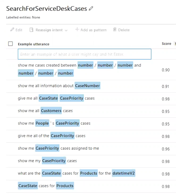

SearchForServiceDeskCases Intent Example
  • In the example below, the intent "SearchForServiceDeskCases" is shown.
  • Note that entities, such as Customers, number, and CasePriority are a kind of keyword that can be recognized by your app.

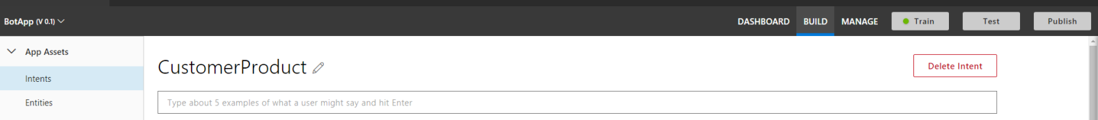

How to Train your LUIS App
  1. Select BUILD from the top menu.
  2. Expand App Assets from the left side menu.
  3. Select Intents. See the graphic below.
  4. Enter 5 or so examples of possible phrases, or "utterances," a user might use. Use the table below.
  5. Select Entities from the left side menu.
  6. Enter a word or phrase inside the utterance that you want extracted.

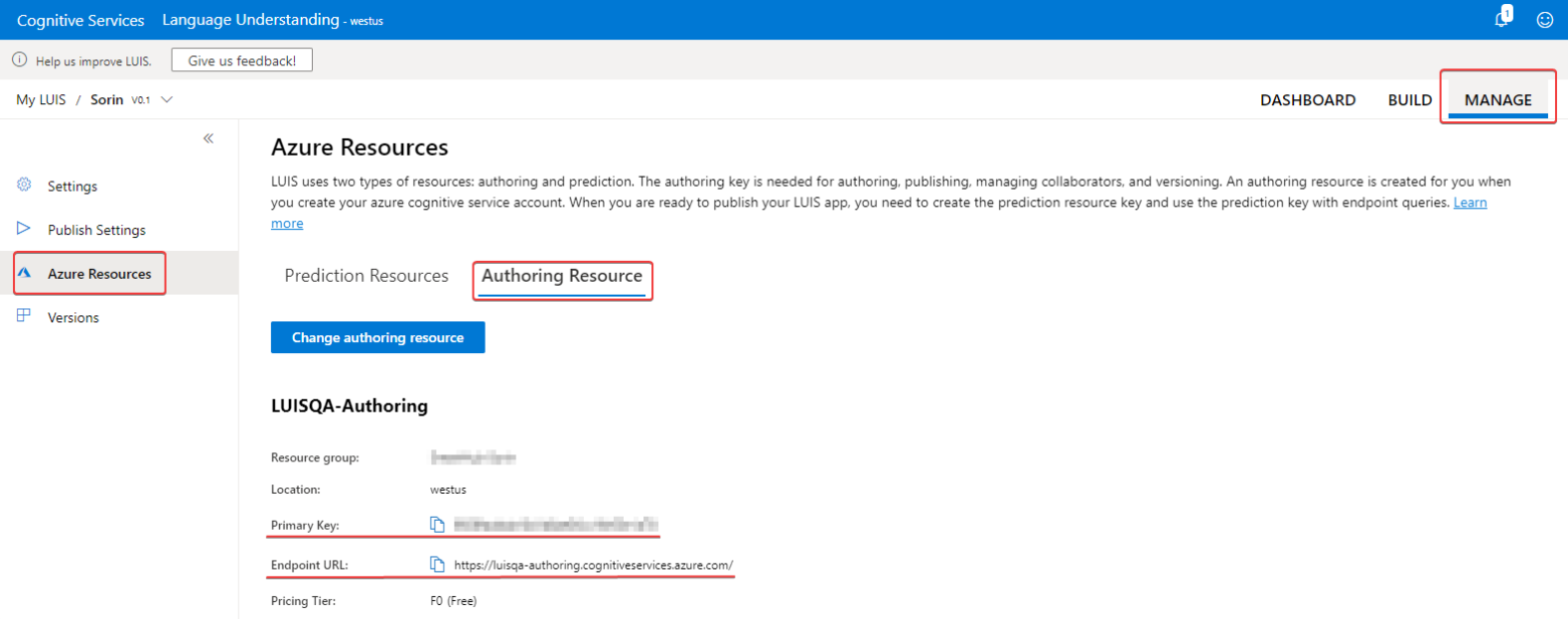

  1. Get the Endpoint and Authoring key
    1. Select the Azure Resources entry from the left-side nav.
    2. The Authoring Key and Endpoint are shown in the screenshot below.

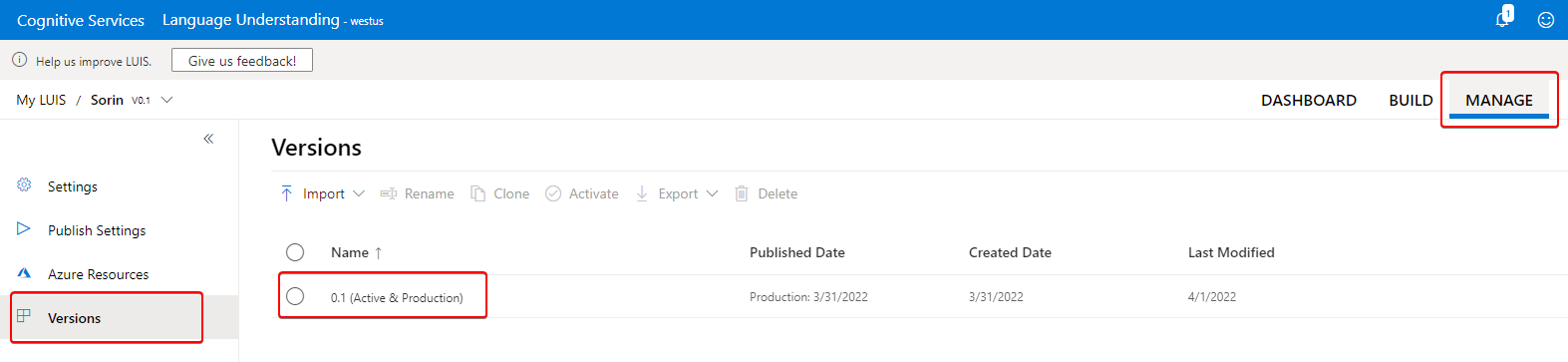

  2. Get the Version.
    1. The Version is shown in the screenshot below:
    2. For this case, the Version from NLQ Service Configuration page is 0.1.
