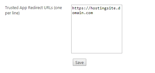

Configure Security in SmartHub Admin
Navigate to the SmartHub Administration page.
Go to the Security Settings section.
Add your Akumina site URL to the Trusted App Redirect URLs field.
Click Save.

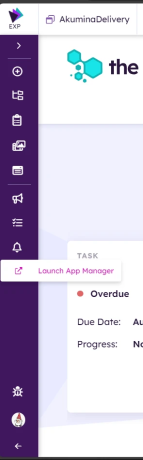

Navigate to the Akumina App Manager by using the toolbar from your site.
Navigate to Akumina Central

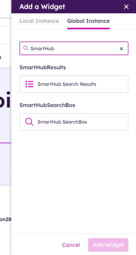

Add the SmartHub Widgets to an Akumina Page
Navigate to the desired Akumina page.
Enter edit mode and add the widget you want to use.

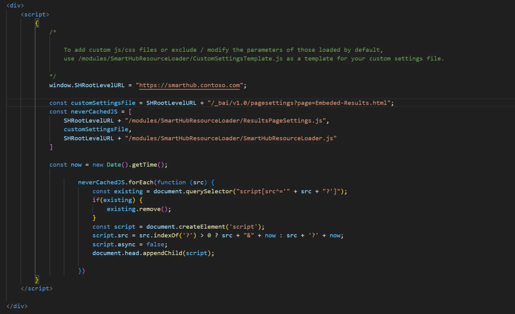

Go to Advanced HTML Edit and make the following changes:
Remove all the non-script tags from the head and everything above the <head> tag.
Replace the <head></head> and <body></body> tags with <div> and </div> while keeping the inner contents of those tags:
For the DIV with ID "search" add a new attribute
data-main="true" -
Replace the src attribute of logo with the absolute URL.
Change the SHRootLevelURL value to your SmartHub root address.
Make sure that
customSettingFileis pointing to "Embeded-Results.html"
const customSettingsFile = SHRootLevelURL + "/_bai/v1.0/pagesettings?page=Embeded-Results.html"; -

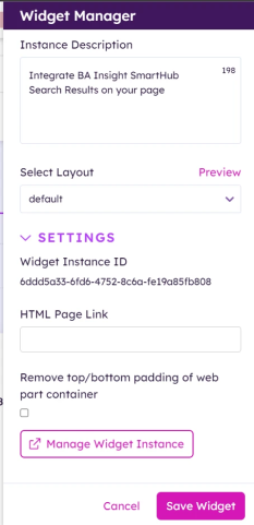

Configure the SmartHubResults Widget
Go to the Akumina Page where you have added the widget
Go to Edit Mode
Select and edit the SmartHubResults widget
Add the Embedded-Results.html complete URL on the HTML page link setting.
Save the widget

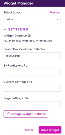

Configure the SmartHub SearchBox Widget
Go to the Akumina page where you have added the widget.
Go to Edit Mode.
Select and edit the SmartHub SearchBox widget.
Set the selector for the container where the SmartHub SearchBox will render.
Add the full URL for the TypeAhead custom settings modified earlier.
Add the full URL for the TypeAhead page settings modified earlier.
Save the widget.
If the container doesn't exist it can be added by modifying the Akumina Master page via the View Manager or the value changed to one that exists in the page.
