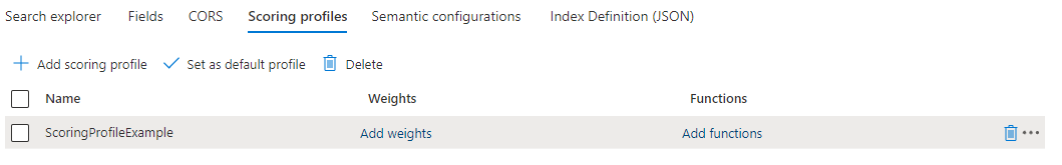

How To Configure Scoring Profile In Azure
Procedure:
  1. Go to your Azure Cognitive Search Service.
  2. Click Overview > Indexes.
  3. Select your index that will be used also in SmartHub.
  4. Select Scoring Profiles > Add scoring profile.
  5. Enter a scoring profile name and click Add scoring profile.
  6. Click Add functions > Add Scoring function.
  7. From the Function type dropdown, select Freshness.
  8. Choose Field name for boosting.
  9. Choose interpolation:
    • Required for scoring functions.
    • Defines the slope for which the score boosting increases from the start of the range to the end of the range.
  10. Choose a Boost value:
    • A positive number used as multiplier for raw score. It cannot be equal to 1.
  11. Choose Boosting duration (Sets an expiration period after which boosting stops for a particular document.)
    1. The Boosting duration must be formatted as an XSD "dayTimeDuration" value.
    2. Example: "P1D" (1 day), "PT15M" (15 minutes)
  12. Click Ok > Save.

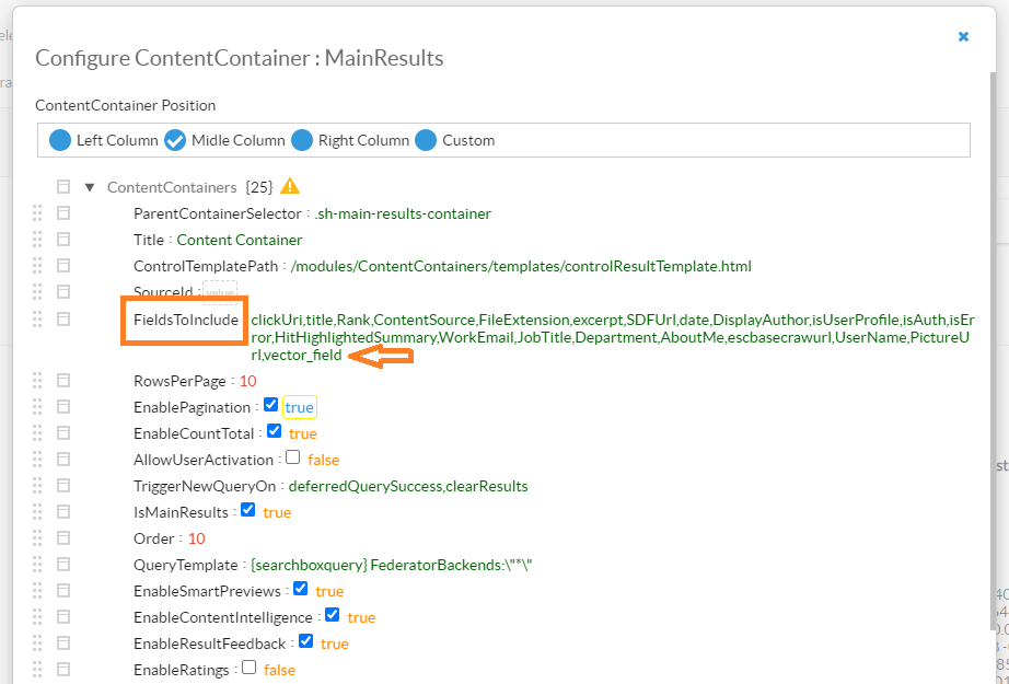

Retrieve And Process Vector Field(s)
Although it is not recommended to return vector field(s) on the returned results, there may be cases when it is needed. To achieve this, do the following:
  1. Navigate to your results page.
  2. Edit this page using the UI Editor.
  3. Select the Basic mode
  4. Open the Customize ContentContainers section.
  5. On the left side panel, select and edit your content container.
  6. Add your vector field(s) to the FieldsToinclude list.
  7. Save the changes.

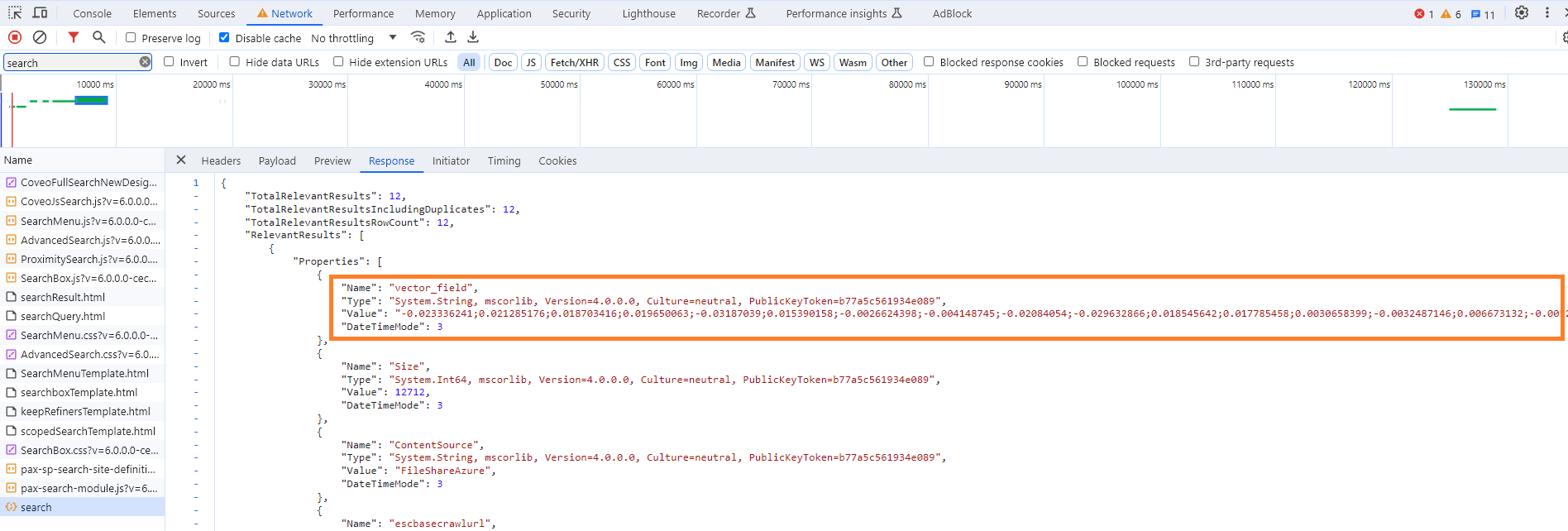

  8. Validate that the vector fields are returned on the results:
    1. Open the dev tools for your browser.
    2. Navigate to the Network tab.
    3. Look for the search request.
    4. On the response, validate that the vector field was returned.
Notice that the values of the vector field are separated by semicolons.
