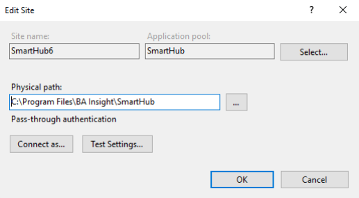

- Open IIS Manager and click Application Pools from the left navigation pane.
- Select your SmartHub Application Pool, which was setup and named when you first installed SmartHub, and click Stop from the Actions menu on the right side pane.
Click Edit Site > Basic Settings to instruct IIS to use the clean SmartHub 6.x unzipped directory path.
- Copy the configuration folder and customization folder into the new SmartHub folder.
- Make sure that your configuration is either decrypted or encrypted using the environment variables. If it is not, use the encryption tool to apply the correct encryption or decrypt the configurations.
