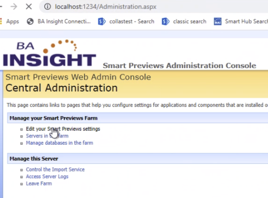

Most of this information can be found from the web admin console. See below.

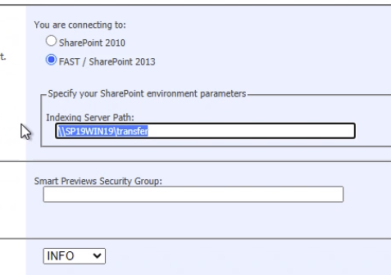

  • On your Smart Previews Web Admin Console page (shown above): Record the path of your current transfer folder.
    Note the example below:

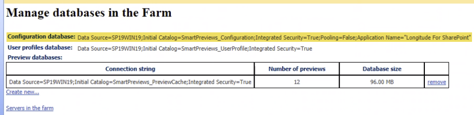

  • Under Manage databases in the farm:Record the "Configuration database" string.

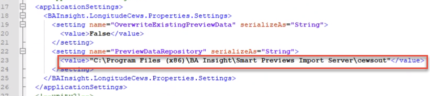

  2. Edit the CewsWindows.exe.config file.
  3. Locate the system.serviceModel\services\service\host\baseAddressesand add/replace the server name (servername).
  4. Locate the applicationSettings\BAInsight.LongitudeCews.Properties.Settings\PreviewDataRepositoryand replace %LocalLow% with the path of the BA-Insight Fast Proxy Incoming folder.

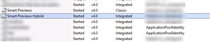

  1. Open your IIS server.
  2. Collect the following information
    1. In IIS, click Application Pools
    2. In the Application Pools list, note the domain\username value in the Identity column of your Smart Preview Hybrid site.

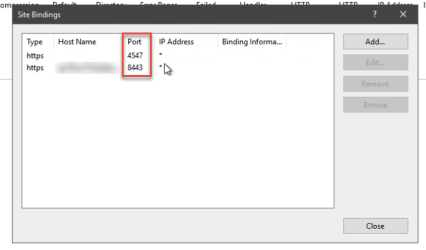

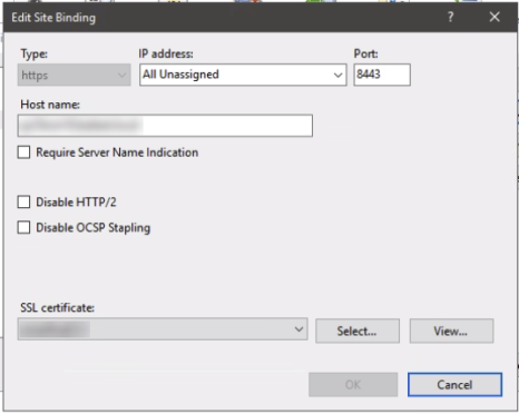

    3. In IIS Click Sites > Smart Previews Hybrid site.
    4. Click Bindings in the Actions panel.
    5.  Note the values for the Port and Host Name columns for your bindings.
    6. Click on your bindings, then select Edit
    7. Note the SSL certificate used for the hybrid site (blurred out below):

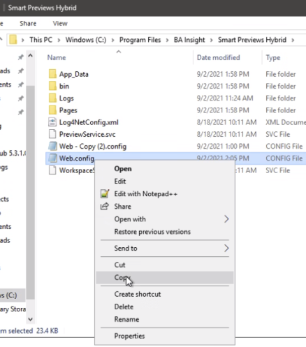

  3. Navigate to your Smart Previews Hybrid installation folder.
  4. Make a copy of your existing Web.config file.
  5. Navigate to the App_Data folder in your Smart Previews Hybrid installation folder.
  6. Make a copy of your existing FetcherConfiguration.xml file. After re-installation, follow the steps in Migrate your previous file information.
Ensure that you have created a copy before you uninstall your previous version of Smart Previews.

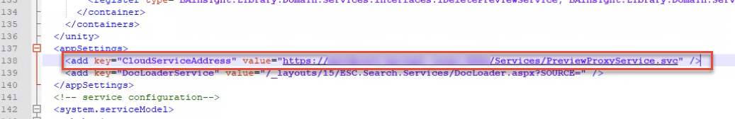

    4. Overwrite the CloudServiceAddress (around line 138) with the value from your old web.config file copy.

  1. Navigate to the Smart Previews Hybrid web site folder and open the web.config file.
    1. Locate the appSettings\CloudServiceAddress section.
    2. Replace the sample address with your Smart Previews Web Resources URL including preview proxy service as in the following example:
      https://[SmartPreviewsAddress]/Services/PreviewProxyService.svc

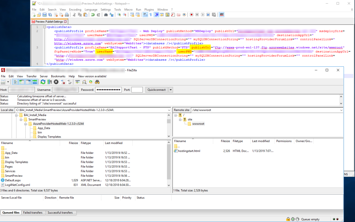

  1. Unzip the file "SmartPreviewsFrontEnd.zip" after modifying it with the App Repackager application.
  2. Using an FTP client, publish the extracted files to your Azure Web app.
    1. The FTP access credentials can be found in the "PublishSettings" file downloaded after provisioning the Azure Web App.
    2. Publish the root of the .zip folder to the wwwroot folder in the Azure site.
  3. Once the FTP transfer is complete, it may take several minutes before the Azure app is available.

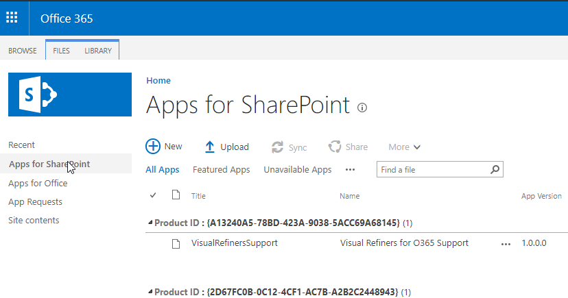

Publish the SharePoint Online App to your SharePoint Online App Catalog
  1. Navigate to your SharePoint Online Admin Center>App Catalog.
  2. Open "SharePoint Apps".
  3. Click "Upload" and upload the SmartPreviewHybridCloud.app that you updated with the App Repackager.
    When upgrading, you must upload a .app file with the same name. If you modify the file name prior to uploading, ensure you keep a note so that the same file name can be used on upgrade.
