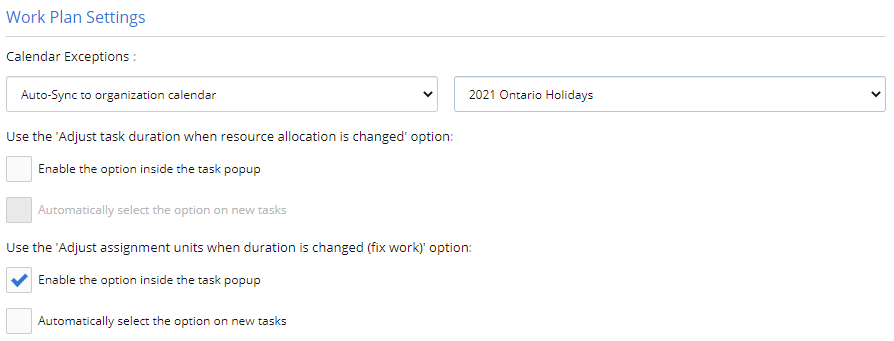

Work Plan Settings allow you to enable three functions:
Calendar Exceptions
Eclipse PPM users can synchronize an Organizational Calendar with a Project (or a Project Template) from the Configuration page. When this occurs, the Work Plan(s) will automatically update to match a custom calendar's Hours Per Day and Exceptions when opened.
There are two drop-down menus for "Calendar Exceptions" under Work Plan Settings:
The first menu contains two options for Calendar Exceptions: "Independent" and "Auto-Sync to organization calendar."
  • Independent: The Work Plan schedule will work independently from any custom calendar in Eclipse PPM. Users with "Modify" Project Schedule permissions will be able to manage calendars on each Work Plan attached to a Project.
  • Auto-sync to organization calendar: All of the Work Plans on the Project will use the calendar selected in the second drop-down menu. If selected, the second drop-down menu will be enabled, allowing users to select a calendar. The Project's Work Plan(s) will automatically update to match both the Hours Per Day and the Exceptions of the chosen calendar, which can be set while managing the calendar from the Administration page.

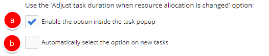

The Work Plan Settings offer two choices for configuring this feature:
  • a. Enable the option inside the task popup: If this checkbox is selected, users can choose to enable this option for a Task while editing a Task in its pop-up window:
    Note: If "Enable the option inside the task popup" is eventually deselected from the Configuration page, any Tasks with "Adjust duration when resource allocation is changed" selected will still have the option available and selected in the Task popup. Once the "Adjust duration when resource allocation is changed" checkbox is deselected and the Task is saved, the option will no longer be available on that Task.
  • b. Automatically select the option on new tasks: If this checkbox is selected, the "Adjust duration when resource allocation is changed" checkbox will be selected by default on any new Tasks.

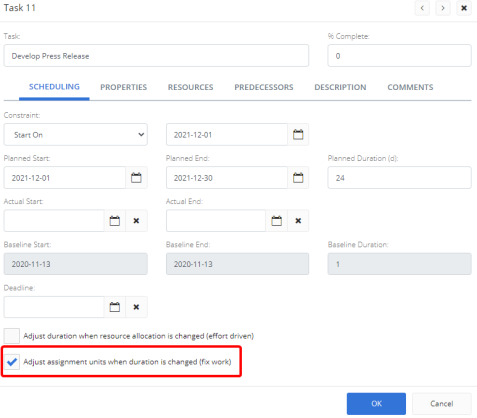

    Note: If "Enable the option inside the task popup" is eventually deselected from the Configuration page, any Tasks with "Adjust assignment units when duration is changed (fix work)" selected will still have the option available and selected in the Task popup. Once the "Adjust assignment units when duration is changed (fix work)" checkbox is deselected and the Task is saved, the option will no longer be available on that Task.
