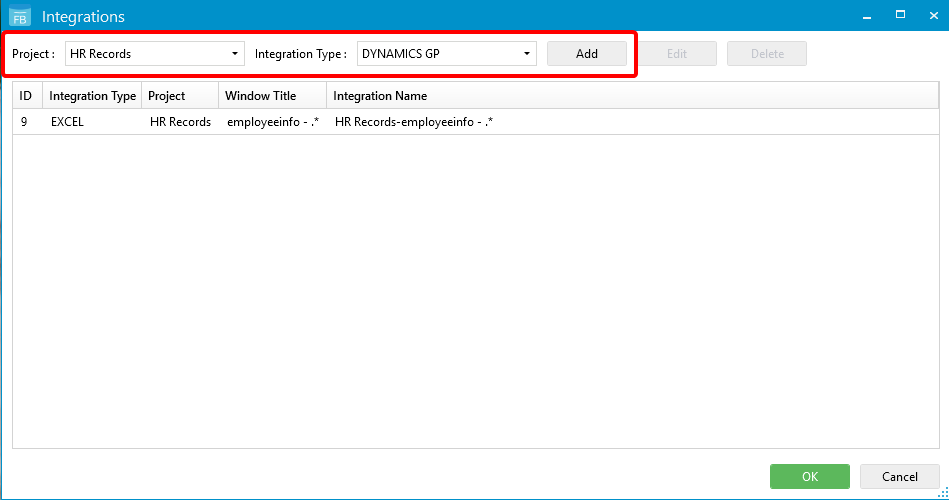

  1. On the Integration menu, click Setup.
  2. In the Project list, select a project that you want to configure the integration for.
  3. In the Integration Type list, select DYNAMICS GP.
  4. Click Add.

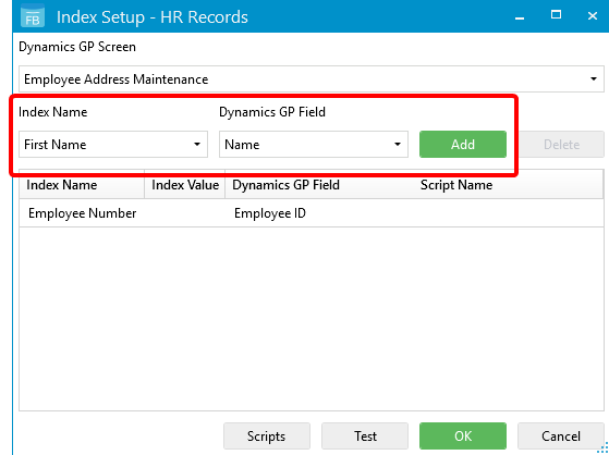

  5. In the Dynamics GP Screen list, select the Dynamics GP screen that you want to map to.
  6. In the Index Name drop-down list, select the index field you want to map data to.
  7. In the Dynamics GP Fielddrop-down list, select the field on the Dynamics GP screen that you want to map to the selected index field.
  8. Click Add
  9. Repeat Steps 5 - 8 to map additional fields.
  10. Open the mapped Dynamics GP screen and click Test to ensure that the mappings return the expected values.
  11. Click Scripts to generate a VBScript or PowerShell script if necessary. The script is applied to the value pulled from the integration for that field. See VBScript and PowerShell scripting for integrations for more information.
  12. Click OK.
  13. Click OK.

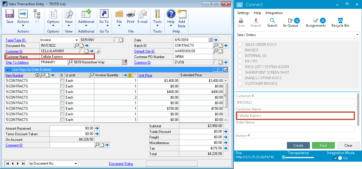

  1. In Connect, select the On option for the Integration Mode. See Status Bar for more information.
  2. Open a record in Dynamics GP to see the mapped data in Connect.
    If a matching file exists in FileBound, the index field information will be populated and any applicable documents will be displayed under separators and dividers.
    If a matching file is not found in FileBound, the Index Panel will display the details of the record with a message No results found, and the Create button is enabled.
