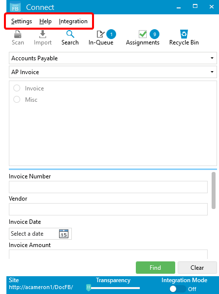

Menu Bar
The Menu Bar is located at the top of the application.
Settings: The options available in this menu allow you to modify Connect options, sign out of the application, and exit the application. See Options for more information about the options available under the Settings menu.
Help: The options available in this menu allow you to view the online help, the privacy policy, and information about Connect.
Integrations: The option available in this menu allows a FileBound System Administrator to set up integrations with Connect. See Connect integrations for more information.

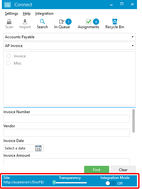

Status Bar
The Status Bar is located at the bottom of the application.
Site: Click the URL to open the FileBound site you are connected to.
Transparency: You can adjust the transparency of Connect for times when you want the application to be displayed on top of other applications.
Integration Mode: This is where you set the integration mode to On or Off. See Connect integrations for more information.
