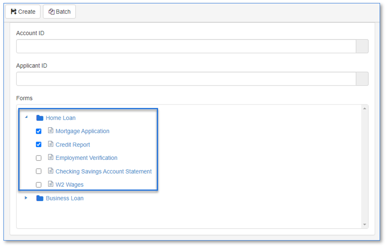

HP CR Client users select the categories and form types associated with a particular document set and capture the appropriate properties by creating Scan Reservations or Batch Routing Sheets.

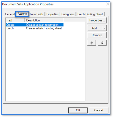

    • Use default or modify actions

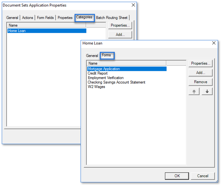

In the Loan Document Set scenario shown above, the Administrator creates a Home Loan category and the following form types.
  • Mortgage Application
  • Credit Report
  • Employment Verification
  • Checking Savings Bank Statement
  • W2 Wages
Categories are created to organize the form types associated with a document set. Form types are placeholders that represent the forms that will be scanned at a device by the Device Client user. The forms are routed by the server based on the rules created by the Administrator. The Scan Reservations or Batch Routing Sheets created by the HP CR Client user contain the following distribution/destination information.
  • Document Set Category
  • Form Types

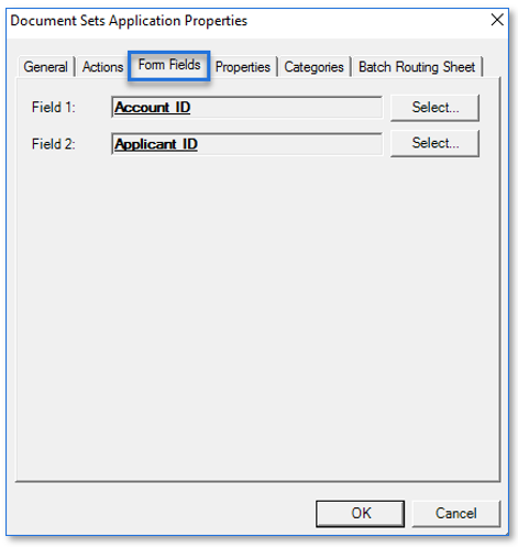

  • Form Fields - used to identify and classify the form types.
  • Form Field properties
  • Form Type properties

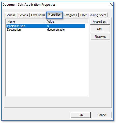

Properties are used to provide additional information about form fields and form types.

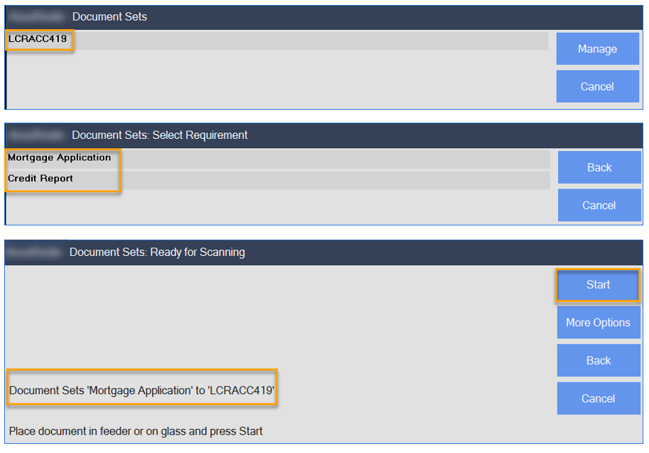

Using Document Sets for Users
Using Document Sets for Device Client Users
