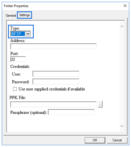

  2. Select the Settings tab.
See the Folder Properties > Settings dialog box example below.
  1. Select SFTP on the Type drop-down list.
  2. Specify the server address in the Address box.
  3. Specify the port value in the Port box if different from the default value.
  1. Specify any of the following credentials.
    • Username (required)
    • Password (optional)
    • Use user supplied credentials if available (optional)
Note: The SFTP server/folder configuration will use the user supplied credentials as an override if it is different from the username and/or password specified when the Use user supplied credentials if available option is selected. If the option is not selected, it will ignore any user supplied credentials.
  1. Specify the PuTTy Private Key file in the PPK File box. (optional) or use the Ellipsis () button to find and select the file, if necessary.
  2. Specify the passphrase in the Passphrase box. (optional)
  3. Click OK.
