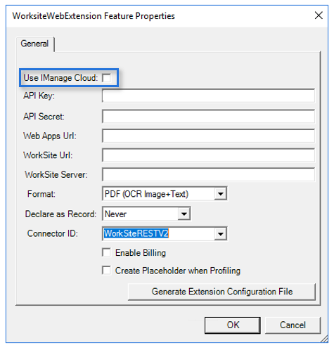

Setting up the WorkSite Extension for On-Prem only
Ensure the following requirements have been met before you set up the WorkSite extension.
  • HP CR Client must be installed and configured for HTTPS.
  • An active Client Option Pack license is required. Contact your Account Manager, if necessary.
  • On-Prem WorkSite server must be 10.3.1 or higher and the WorkWeb component must be 10.2.6.61 or higher.
  • The WorkSite or WorkSiteRESTV2 connector must be set up. See iManage On-Prem Server – Setting up WorkSiteRESTV2 connector (Server version 10.3.1 or higher) for more information.
  • The WorkSite extension must be set up in the Server Administrator.
Note: Although you can use the new WorSiteRESTV2 connector for your On-Prem server environment, HP CR recommends that you use the WorkSite connector instead.
Expand to view more information.

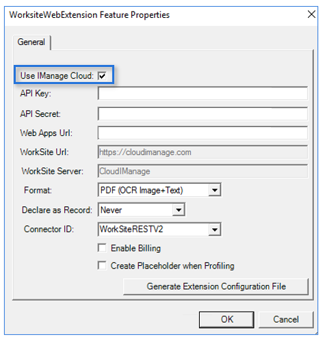

Setting up the WorkSite Extension for Cloud only
Ensure the following requirements have been met before you set up the WorkSite extension for Cloud only.
  • Contact iManage and HP CR Support to get the WorkSite extension registered for your account.
  • The WorkSiteRESTV2 connector must be set up. See iManage Cloud Server – Setting up WorkSiteRESTV2 connector for more information.
