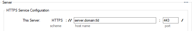

The HTTPS Service Configuration fields use the Fully Qualified Domain Name (FQDN) of the server, along with the desired port for HTTP Service traffic.
This URL is required when configuring a telephony gateway in the Admin App.
InGenius requires a 3rd party certificate for the server to validate the FQDN for HTTPS traffic. Bind or unbind the server certificate to validate the FQDN for HTTPS traffic on the required port. For more information on setting up a certificate for InGenius refer to Certificate Management.
Note: An icon appears on the port if it is blocked. Click on the icon to add a firewall rule.

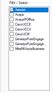

Enable the connection between the phone switch and InGenius. Select your telephony system from the list to display the settings for that phone system.
Phone System Settings
Navigate to your telephony system below to view its gateway profile configuration steps:
To configure the Asterisk gateway profile:
- Select the Asterisk checkbox on the left-hand side of the Configuration Tool. This brings up Asterisk connection information.
