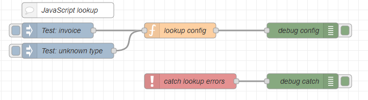

In this approach, the overall flow structure remains largely the same. The change node that previously performed the JSONata lookup is replaced with a function node. A third flow is introduced, using a catch node to handle any errors raised during lookup execution.
Two workflows: One for Javascript lookup, and one for catching errors. The nodes are desribed in the following text.
