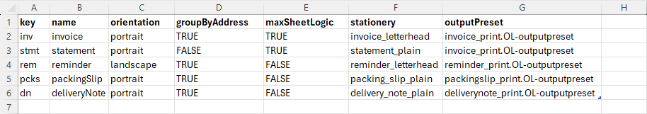

Working with tabular data is one of the most common integration scenarios. In many environments, reference data or configuration tables are maintained as CSV files, often created or maintained in spreadsheet applications such as Microsoft Excel. This approach is well-suited to smaller datasets that follow a row-and-column structure.
A spreadsheet, showing 7 columns of data that describe a printed document, such as name and orientation, a row of headings, and 5 rows of data for different printed documents.

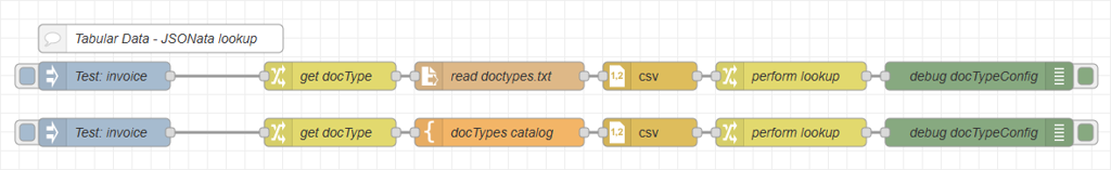

Data inline with the flow (message-scoped)
Two flows, showing nodes as described in the text following.
This approach is appropriate when only a single flow requires access to the configuration data. The dataset can either be:
  • Loaded from disk using a read file node.
  • Embedded directly in the flow using a template node.
Reading from disk ensures the latest version of the file is used, but it introduces runtime overhead because the file is read and parsed for every message. For small datasets, this is typically acceptable. A more efficient pattern, loading once at startup and storing in a flow variable, is covered separately.
In this section, the configuration is recreated per message and remains scoped to this flow.

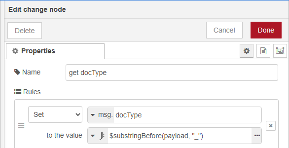

  • The change node extracts the lookup key (document type prefix) from the filename.
    • Configure the node Properties Rules to set the lookup key as msg.docType
    • Enter the JSONata expression value to $substringBefore(payload, "_")
The properties window of the change node, showing rules completed as described in the preceding text.

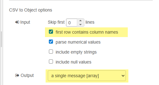

  • The csv node converts the CSV content into structured JSON.
    • Configure the node Properties as follows to produce an array of objects in msg.payload, where each object uses the CSV column names as keys:
      • In the Input section, enable first row contains column names.
      • Set Output to single message [array].

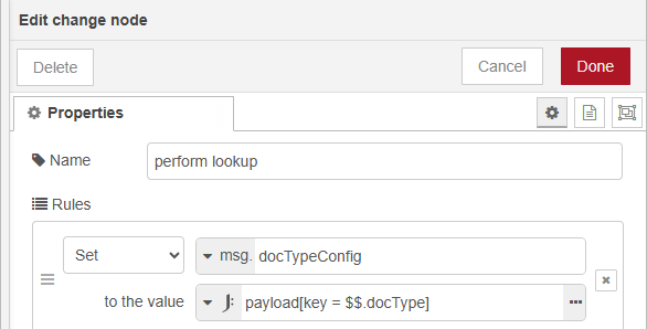

The change node performs the lookup using JSONata and stores the result in msg.docTypeConfig.
  • Configure the node Properties to use the value
    JSONata expression: payload[key = $$.docType]
  • This lookup does not have direct access the docType using msg.docType. The $$ prefix assures the docType is read from the root, in this case from msg.docType.
  • This filters the array and returns the object where the key column matches msg.docType.

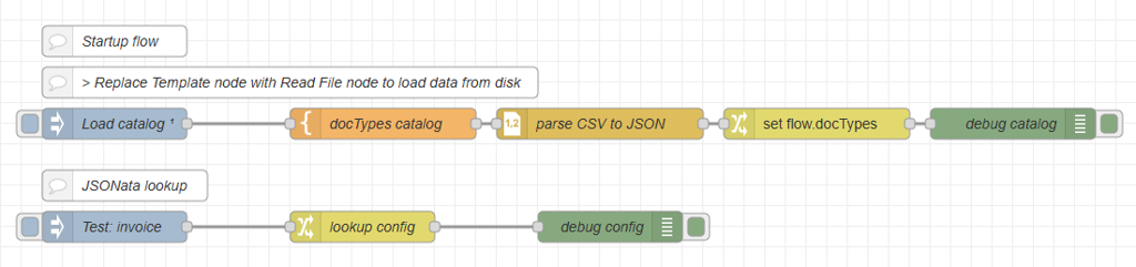

Data in a flow variable (shared configuration)
When multiple flows require access to the same configuration data, and when you want to clearly separate configuration loading from production logic, it is more efficient to centralize the loading process.
Instead of loading and parsing the dataset for every message, the configuration can be loaded once in a dedicated startup flow. This flow is responsible solely for reading, converting, and storing the reference data.
The configuration is then stored in a flow-scoped variable, making it available to all production flows on the canvas. This approach provides eliminates repeated file reads and parsing overhead, ensures a single source of truth and separates operational configuration from processing logic.
Flow overview
  • Flow 1: Inject (run on startup/deploy) > Template or Read File > CSV > Change
  • Flow 2: Inject > Change or Function > …
Flow 1 - startup flow nodes

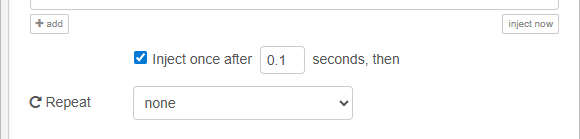

  • The inject node triggers the flow once after startup/deploy. This ensures the configuration is loaded before production traffic begins.
Configuration panel for the inject node, showing inject after 0.1 seconds, no repeat.
  • The read file node loads the CSV configuration file from disk. Alternatively, the CSV content can be embedded directly using a Template node configured to output Plain Text. Data is read to msg.payload.
  • The csv node converts the CSV content into structured JSON, and is configured as outlined above.
  • The change node sets flow.docTypes to the content of msg.payload.

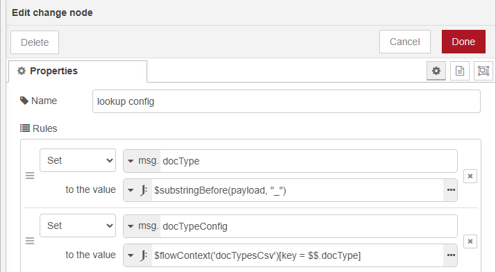

  • The change node extracts the lookup key (document type prefix) performs the lookup. The properties are configured with two rules:
    • Rule 1 extracts the document type from the file name, using a JSONata expression, and stores it in msg.docType: $substringBefore(payload, "_")
    • Rule 2 performs the lookup in flow.docTypes, using the extracted document type with a JSONata expression, and stores the configuration in msg.docTypeConfig.
      • The JSONata expression is : $flowContext('docTypes')[key = $$.docType])
The properties panel of the change node, with two rules entered as described in the preceding text.
